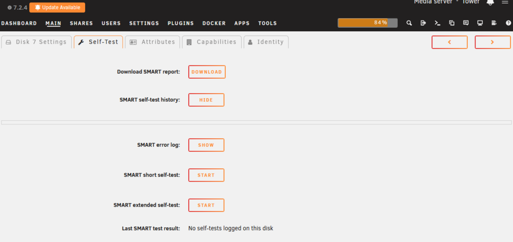

Running the extended SMART test on a drive is a good indication of a drives health.
The array won't let me run any self-tests, if I click on either sefl-test nothing happens?
Probably worth posting diagnostics zip file created after a failure trying to run the self-test so we can see why it failed.

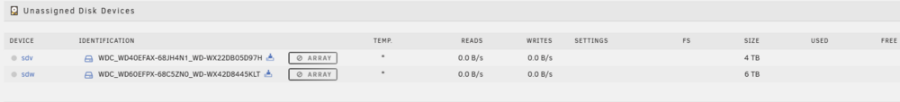

Both disks disconnected and reconnected as Unassigned Devices. Do the extended tests on the Unassigned Devices.
SMART for those Unassigned Devices looks OK, but both disks were logging critical medium errors before they disconnected. So definitely do the extended test on both.

Both existing disks tested OK with a long SMART test, however I have stopped the array and tried to add one of them.
It's listed but when I select it as an array disk, it's immediate changed to not assigned. I have tried with the other disk and this has the same effect?
I have cleared both disks, and both are available to to preclear. I am thinking about preclearing the Disk 8 (4TB) to see if it will then let me add it to the array.

The failed disks are shown as unassigned devices, and are available to preclear, I can't understand why I couldn't reassign them back to the array? I've been running Unraid since V3 and have not seen the behavior before.

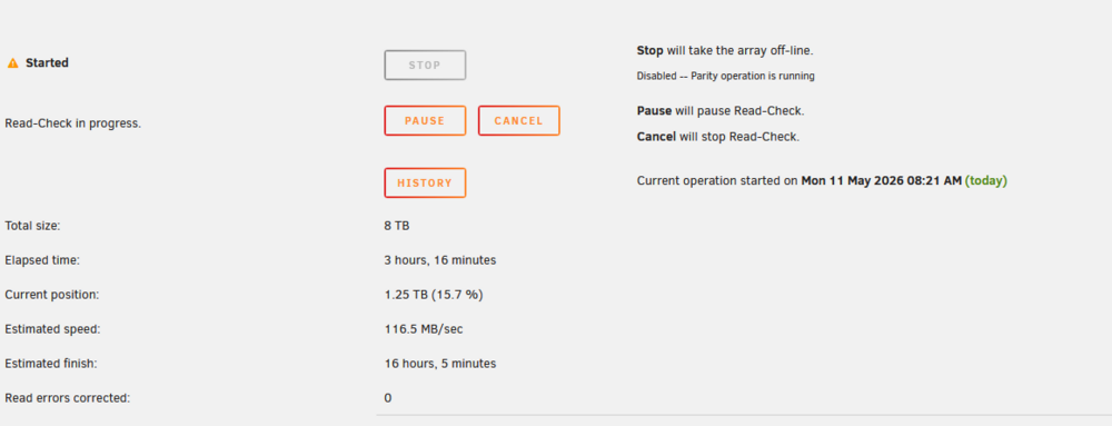

After restarting rebuild i have noticed that it has logged 54 faults.
I thought that I'd resumed the rebuild after the faults were logged, but i have noticed it is doing a read check instead?
Shall I let this complete, or power down / check data & power leads + move disk to another controller?
A read check implies the dtive was disabled (red ‘x’), and if so not a lot of point in continuing the check. Can’t do more than guess without diagnostics.
