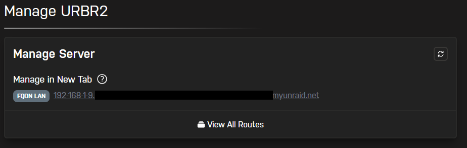

(Viewing the server In unRAID Connect.)

(Browser error when clicking the link in unRAID Connect.)

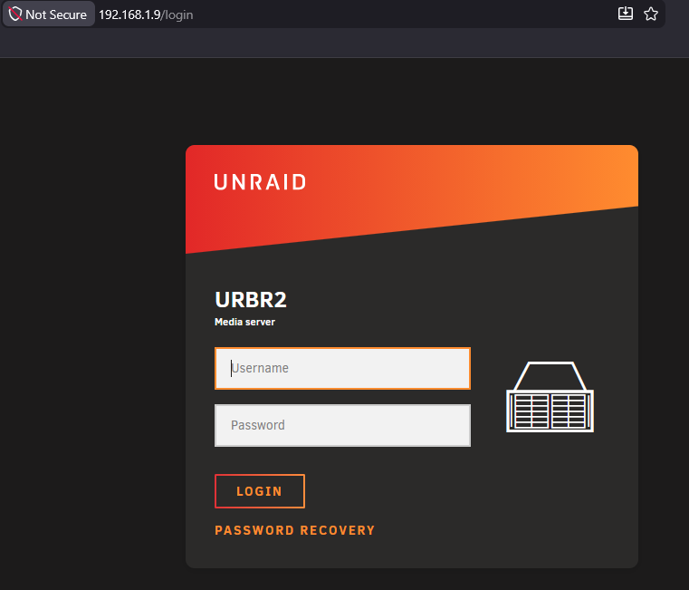

(Trying the local IP address.)

(Now can get to it with the local IP.)
