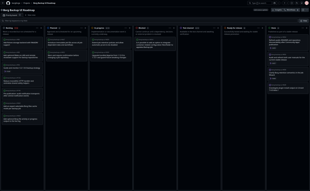

Hello everyone,
with the new version 2026.09.04.1114, the retention behavior should hopefully be much clearer.
The Job Wizard now explains that retention values represent time periods, not the number of archives within each period. For example, “20 daily restore points” means that up to one matching archive is retained for each of 20 days—not 20 archives per day.
The following points are now explained more clearly:
  • 0 disables only the corresponding retention rule; it does not mean “keep unlimited archives.”
  • At least one retention rule must have a value greater than 0.
  • The configured retention rules are applied automatically after a successful backup.
  • Prune deletes archives that are not selected by any retention rule.
Additional retention options are already planned and tracked in GitHub Issue #459. These include:
  • multiple restore points per day
  • hourly retention
  • keeping a specified number of the most recent archives
  • keeping all archives within a specified period
  • an explicit option to keep every archive
  • separate controls for disabling the automatic Prune, Compact, and Check maintenance steps
These operations will be clearly distinguished:
  • Prune removes archives according to the configured retention rules.
  • Compact reclaims repository space after archives have been deleted.
  • Check verifies repository integrity.
Disabling these maintenance operations will include clear explanations of the consequences. In particular, “keep all archives” will become an explicit setting instead of being represented through ambiguous retention values.
Thank you again for the feedback—it helped us make the current retention behavior much easier to understand.

Borg Backup UI – Public Roadmap
Borg Backup UI now has a public roadmap on GitHub. It shows which topics are planned, what is currently being worked on, what is available in the test channel, and which changes have already been released.
The roadmap will be updated continuously. Priorities may change based on bug reports, required maintenance, or community feedback, so it should not be considered a binding release commitment.
➡️ Open the Borg Backup UI Roadmap
Feedback and suggestions are, of course, still welcome in the forum or through GitHub Issues.
The image below shows a current snapshot. Please use the link for the latest status.
