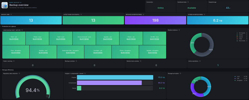

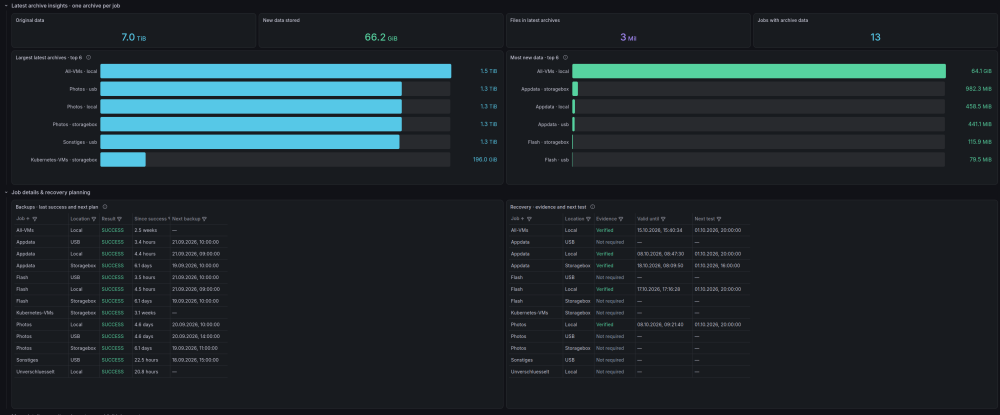

Preview: Grafana dashboard for Borg Backup UI
I’m currently working on optional Prometheus integration and a dedicated Grafana dashboard for Borg Backup UI.
The dashboard brings backup status, storage statistics and restore verification together in one overview:
  • Color-coded status cards for each backup job and location.
  • Repository sizes, archive counts, and savings from compression and deduplication.
  • Comparisons of the largest archives and newly stored data.
  • Restore verification results, evidence validity and upcoming scheduled tests.
  • Indicators for overdue backups and restore tests.
  • Filters for server, location, repository and job.

The dashboard is currently being tested. The screenshots show the current design.
What information would you find most useful? Feedback on the layout is welcome tool

Borg Backup UI 2026.09.23.0926 – Prometheus, Grafana and more flexible restores
This update adds optional Prometheus integration and a dedicated Grafana dashboard to Borg Backup UI.
The included dashboard brings together backup results, active jobs, duration, storage sizes and savings, restore-test evidence and planned tests. Server, location, repository and job filters help you find the information you need.
Set it up under Settings > Integrations > Prometheus & Grafana. You will find a separate access token, a matching Prometheus configuration and the dashboard download. Prometheus and Grafana run separately; no additional exporter is required. The integration is disabled by default.
Metrics collection reads existing plugin data with an in-memory cache. It does not run additional Borg commands or refresh repositories. Historical charts begin when Prometheus starts collecting; running-job visibility follows the collection and refresh intervals.
Browse & Restore is now more flexible too. Alongside the existing job filter, you can show all archives in the assigned repository or use a custom name pattern, such as documents-*. This also lets you select archives created with naming schemes from other applications, without changing backup names or retention rules. A job assigned to the repository is still required for now.
Setup guidance and the new archive-filter interface are available in German and English. The Grafana dashboard uses English labels.
