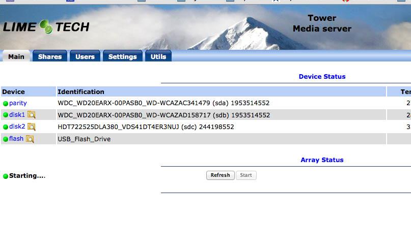

Since I had a power outage, the Webgui page loads only partially:
The buttons in the lower half (start, stop Array, etc. ) don't appear.
The upper half (Disks overview) seems ok.
A message 'Starting'  + a green dot are there, that's all. (Screenshot)
While there seems no Parity Check going on.
The array is active, I can access the folders through the network.
Terminal access is ok.
UUMenu works ok.
I tried then to upgrade to rc 4, but then the WEBGUI was completely gone.
Downgrading to rc 3 - same situation as before.
Thanks for any advice..

looks to me like you are starting a lot of add-ons.  One, or more of them is probably accessing one of the mount points of the disks BEFORE they disks are mounted.  That would prevent the unRAID array from starting since it cannot mount the disks.
Disable your add-ons.  Determine which is not waiting for the array to come online, then fix it so it will, or contact its author for a fix.  There are quite a few like yourself having issues starting the array with add-ons starting prematurely.  You are not alone.
Joe L.
Seems that SABNZBD plugin is the culprit.
So, problem solved.
Thanks!
(Still puzzled by how this could change after a powerfailure, on a previously
OK system.)
That's simple enough to take an educated guess at it, after the power failure when the system was booting up, unRAID took longer to load because of filesystem journal playbacks while one of your plugins isn't coded properly to wait until unRAID is fully loaded before starting.
