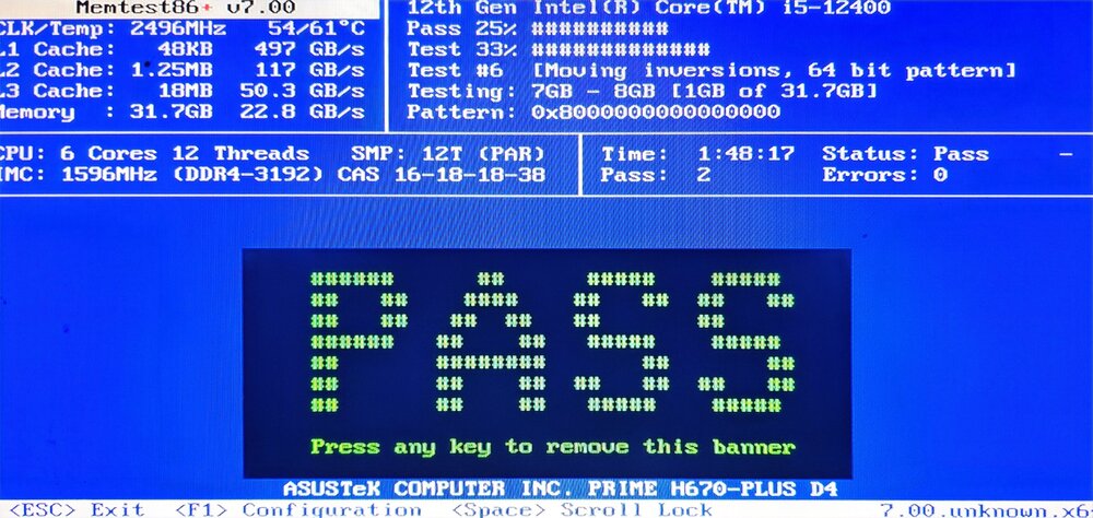

Btrfs is detecting a lot of data corruption. This is typically bad RAM, and could be related to xfs_repair failing, if the RAM really is failing, recommend running memtest first.
Thankfully given current RAM prices, the memtest passed. I let it run through two complete passes before bringing the server back up.
Reset the pool stats and scrub the pool, then post the scrub results if there are any new errors.

Since memtest didn't detect any issues, they may be old errors, but note that memtest is only definitive if it finds errors, so keep monitoring the mpool. If new corruptions are detected, there's still a problem.
