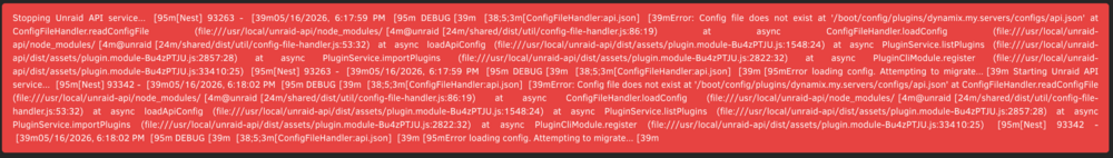

I attempted to upgrade Unraid this afternoon from 7.2.5 to 7.3, the web interface did not come back on and when I connected a monitor to the NAS it showed a different IP address but I couldn't access it via a browser. I powered off the NAS and connected the USB boot drive to another port and it started up with th original IP address but I'm seeing alot of weird errors.
There is an error in the top left Warning API is Offline. I've tried to restart the service but I get the following error.

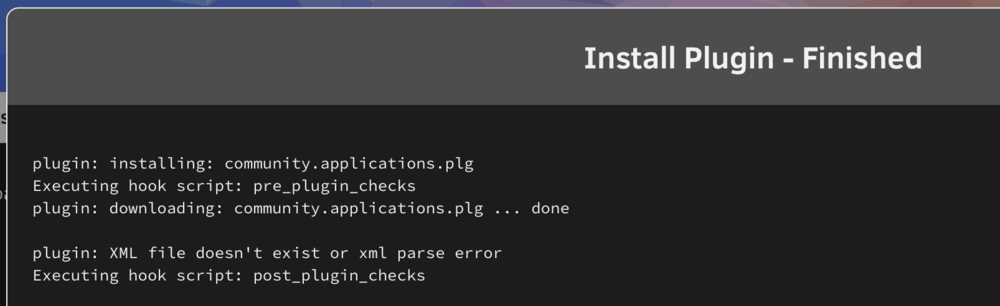

It now looks like the Community Plugin is missing and it won't reinstall.

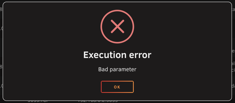

And most of my Docker containers have started back up but alot of them won't start and fail with an Execution Error.

May 16 17:37:17 Bunker kernel: FAT-fs (sde1): error, fat_get_cluster: invalid cluster chain (i_pos 0)
Flash drive problem: you try running ScanDisk on it, or just recreating it, if issues persist, replace it.
