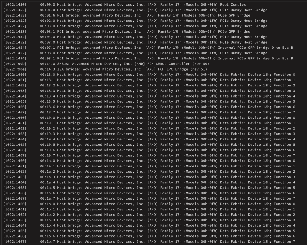

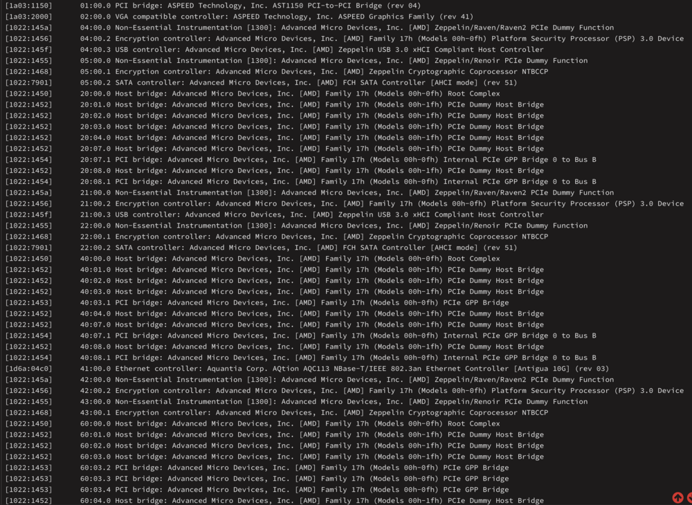

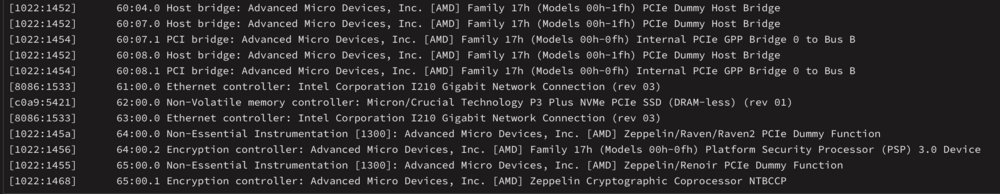

Go to Tools - System Devices and see if the controllers shows there.
thank you this is a good lead, i am see a bunch of lines saying host bridge under pcie so i am hoping that is it? here is what i see tho for more info
so i guess the issue is if it is in fact seeing the how do i get teh system to see the drives i have plugged into the card?

No LSI HBA is being detected by Linux, try another PCIe slot or see if it's detected in a different PC.

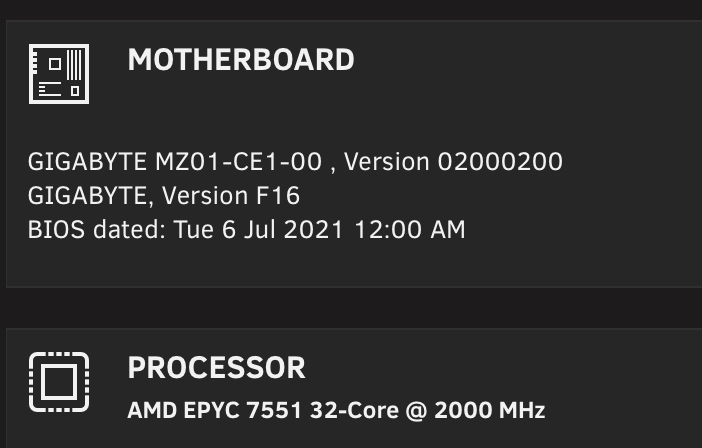

i dont know if maybe its an issue with the hba compatability with the board ? or if you have any other suggestions or other solution for expansion

Could be, or the HBA is dead.
i got a replacement card and it still isnt showing, so it seems i need to look into board compatability
