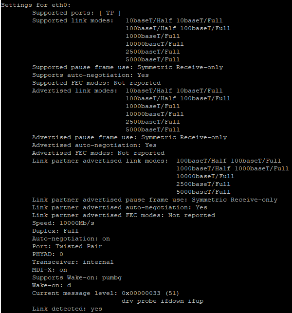

Anyone else experiencing this issue? I have the same thing.
I've tried the custom package here: https://github.com/ERSTT/unraid-r8127-driver
I've also tried the baked in ones. My Ubiquiti shows the unraid server at 10 Gbps, but ethtool eth0 shows link supported modes at 5 Gbps.
Interestingly enough it says it can do 10000Mb/s, but the auto negotiation only has 5 Gbps.
Supported ports: [ TP ]
Supported link modes: 10baseT/Half 10baseT/Full
100baseT/Half 100baseT/Full
1000baseT/Full
10000baseT/Full
2500baseT/Full
5000baseT/Full
Supported pause frame use: Symmetric Receive-only
Supports auto-negotiation: Yes
Supported FEC modes: Not reported
Advertised link modes: 10baseT/Half 10baseT/Full
1000baseT/Full
10000baseT/Full
2500baseT/Full
5000baseT/Full
Advertised pause frame use: Symmetric Receive-only
Advertised auto-negotiation: Yes
Advertised FEC modes: Not reported
Link partner advertised link modes: 100baseT/Half 100baseT/Full
1000baseT/Half 1000baseT/Full
10000baseT/Full
2500baseT/Full
5000baseT/Full
Link partner advertised pause frame use: Symmetric Receive-only
Link partner advertised auto-negotiation: Yes
Link partner advertised FEC modes: Not reported
Speed: 10000Mb/s
Duplex: Full
Auto-negotiation: on
Port: Twisted Pair
PHYAD: 0
Transceiver: internal
MDI-X: on
Supports Wake-on: pumbg
Wake-on: d
Current message level: 0x00000033 (51)
drv probe ifdown ifup
Link detected: yes
Update, so those tests went FROM my Unraid TO my router.
When I went FROM my router TO Unraid... I get much higher speeds.
image.pnge
Both capture ( text & pic ) show have 10000baseT and both negotiation at 10000Mb/s
1000baseT/Full
10000baseT/Full
2500baseT/Full
5000baseT/Full
Thanks! I did spot that, I just was confused by the iperf3 outbound vs inbound, outbound shows 5 Gbps, inbound (as server) runs almost full speed.
