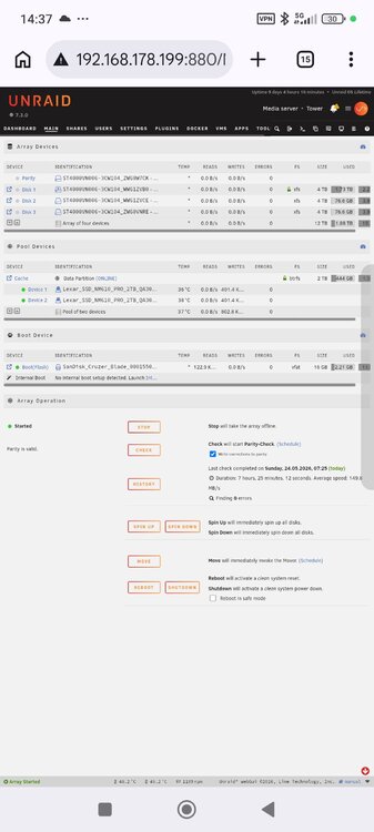

I have a cache with 2 m2ssd btrfs and raid mirror.
Is it possible to remove 1 ssd from the cache pool and then create there the boot device and after that move the data to the boot devices.
And after that add the 2. ssd as mirror to the boot pool or is this not possible?

at the moment it looks like this. I give it a try in the evening.
