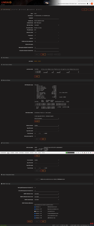

I upgrade my one server to 7.3.0 from 7.2. (5 iterations prior) and one of my Cache pool drives is now throwing loads of errors. (see attached)
Is it really just coincidental that the drive failed at the same time I upgraded?
Or did I miss something along the way during the upgrade?

Pools were not monitored pre 7.3, so the issues were already there; you just weren't notified.
Scrub the pool, and if there are no uncorrectable errors, reset the stats and keep monitoring. The current errors suggest one of the devices dropped offline in the past, most often due to a power/connection issue.

I did try to "scrub the pool" and it did not seem to make a difference. I will do it again anyway.
Scrubbing the pool won't change anything; it's just to confirm
5 minutes ago, TechMed said:
Would you point me to the directions to "reset the stats", please?
Click the first pool device, then RESET in the "pool device status" section; no need to reboot.
