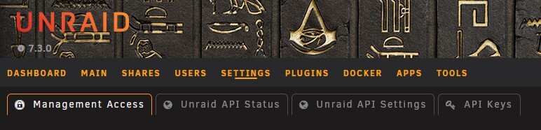

Where is Automated Flash Backup on Unraid 7.3.0?
I want to set up automated flash backup for my Unraid server. The (docs)[Automated flash backup | Unraid Docs] say it's at
Settings → Management Access → Unraid API.
But when I go to Settings -> Management Access, the tabs are:
  • Management Access
  • Unraid API Status
  • Unraid API Settings
  • API Keys
And nowhere in any of the Unraid API tabs does it mention flash backup.
So - where did it go?

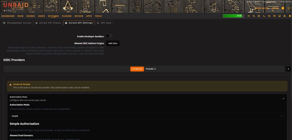

What plugin is this?
I installed unraid Connect but there is no "Unraid-API"...
Edited by Zonediver

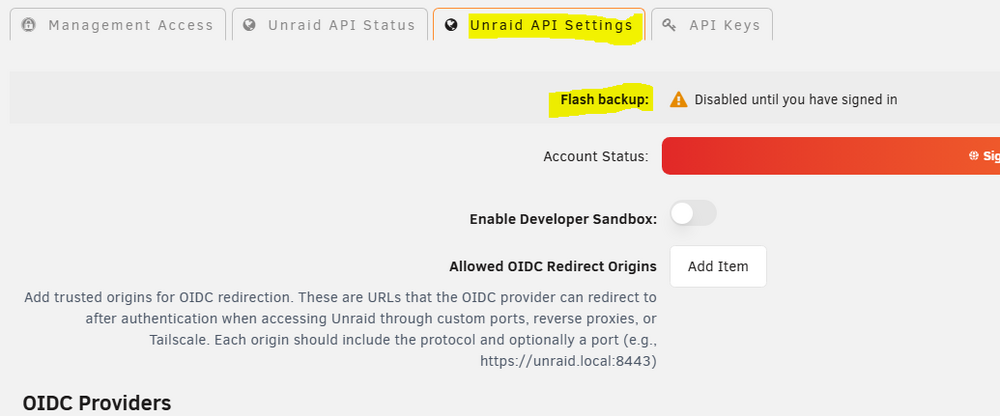

With the plugin installed, it's in the API settings Tab
In my case, it looks completely different...
