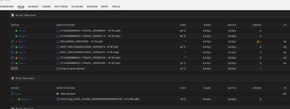

Following an OS upgrade, my system came back up with two drives disabled. I checked the SMART status and they both looked good, so I mounted in maintenance mode and tried running an xfs_repair on each from the UI and it said it fixed the corruption. Unfortunately, they were still in a disabled state. Per some info I found on the forums, I heard the correct way to handle this was to let them rebuild from parity by removing them in maintenance mode, starting, then stopping an re-adding in the same slots - so I attempted to do so. I still have one showing a read error, but it the rebuild has started.

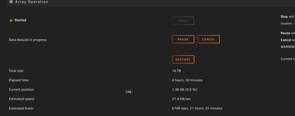

Thanks - tried that, docker still doesn't seem to want to start. I'm noticing my rebuild is running impossibly slow. At this point, estimated time of completion is going to be 12 years from now...lol. I still feel like things are really unhappy.

Post new diags please.
Try starting the rebuild again for disk1, to see if there's still a write error.
Your system share has files on disk1, might be a good idea to fix that before rebuilding. You will have to disable Docker in Settings before you can work with that share.
