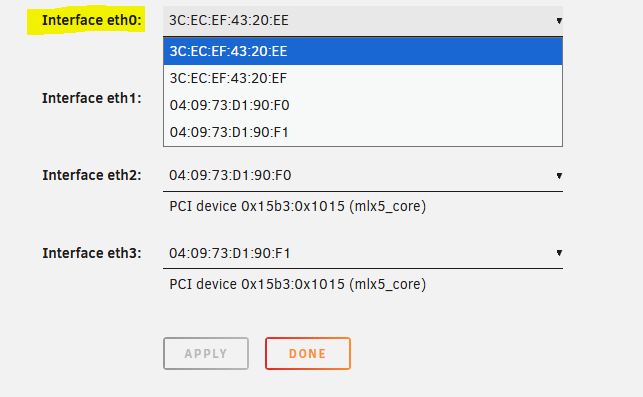

You must set the new NIOC as eth0, that can be done in Settings - Network Settings - Interface Rules (reboot required).

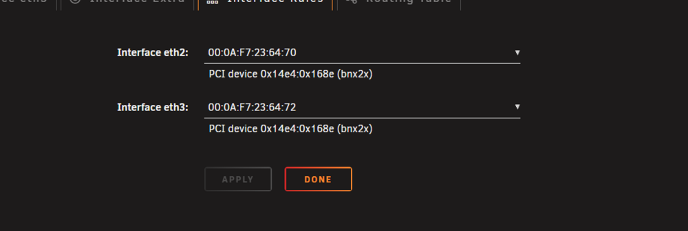

Update/Workaround
The Interface Rules page only allows swapping MAC addresses between existing interface names (eth2eth3), it does not allow renaming an interface to eth0.
The working workaround is to create a dummy eth0 interface at boot by adding the following to /boot/config/go:

16 hours ago, Christian_P said:
I hope you are trolling since that is just not possible.
Not sure what you mean, as mentioned, you can set whichever NIC you want as eth0
Not on my server
Delete /config/network-rules.cfg on the flash drive and reboot
