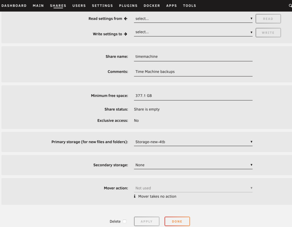

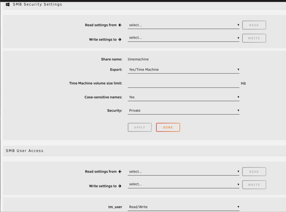

I create a share named "timemachine" with the following config:
Create a user named tm_user which has read/write permissions to the share.

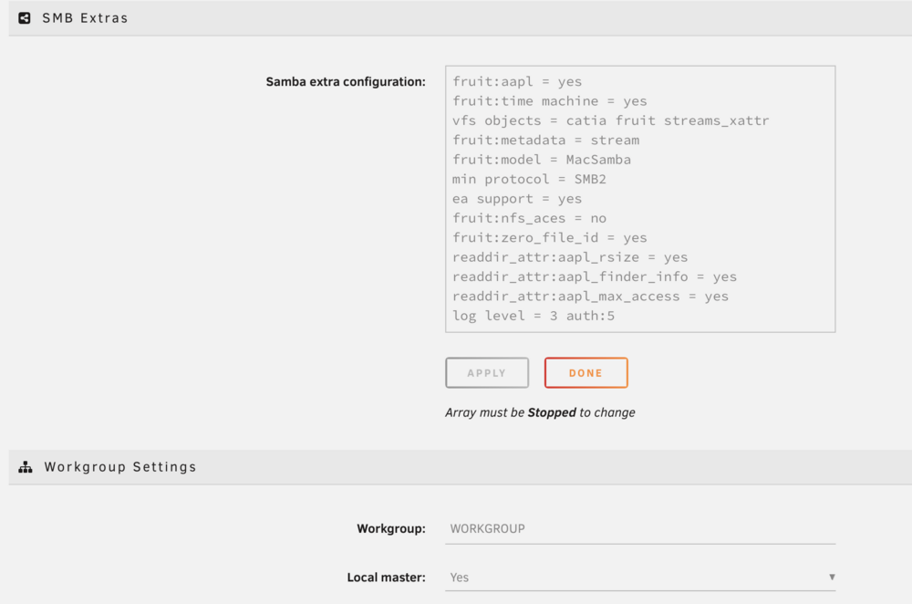

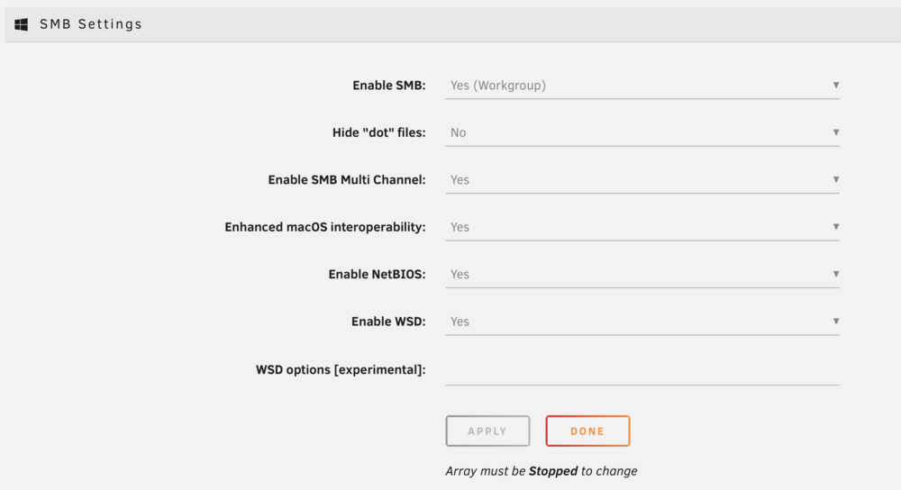

General SMB settings are:
SMB Extras are currently (but original there were none when I first saw this error):

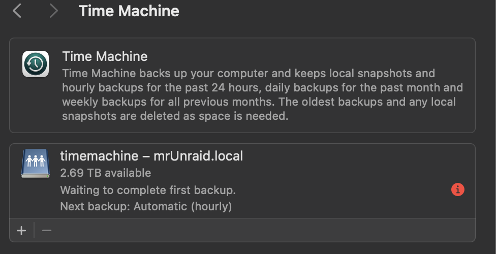

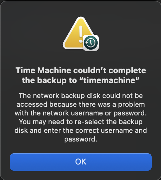

I mount the Time Machine share, either directly with the machine ip or with the following and enter the user and password that I created in unraid (tm_user), I can use finder to go onto the share and create a dir but I always see an error when Time Machine tries to backup.
I tried setting the share up as public and it seemed to work and start creating a backup but Id prefer the share to be private and believe this should be possible?

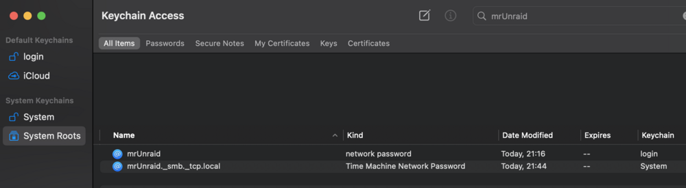

Username/pass look like they are stored in keychain ok
What are these two passwords for? You should only use one password for your apple client computer to log into your Unraid server for file access (SMB). (I probably should avoid answering your query as I have zero experience with the Apple environment...)
Thanks for the reply.
These are just auto added as far as I can tell. I think they are added when I try and access the share through finder.
They both have the username tm_user and password I set up so shouldn't cause any auth issue no matter which is used.

You didn't set a cap. Wouldn't be surprising having that left empty would prevent it from working.
Usually when there's a setting field you need to define it.
