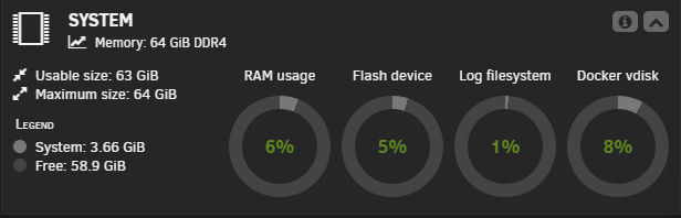

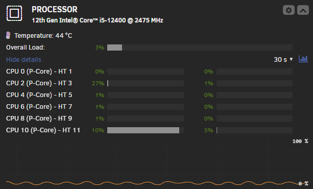

Thanks a ton for your help. Changed Global Share Settings to max as well as the step in your link (touch /boot/config/fastusr). Will see how it goes. As for CPU and RAM resources, I'd be surprised if those were exhausted. Granted I've only got two out of over a dozen dockers running but it is still crashing with just the two.

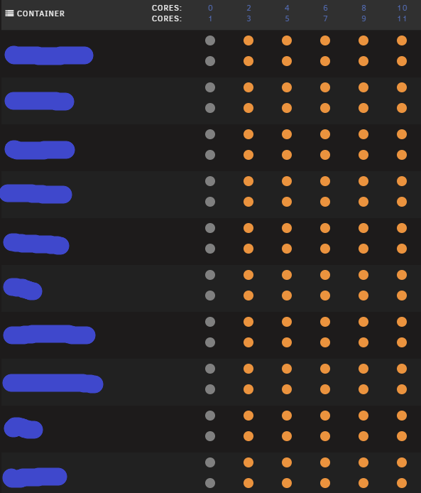

Took your advice though and pinned CPUs. I set CPUs 2-11 for Docker and left 0-1 for the system. Does this look reasonable? Never messed with these settings before. Didn't do anything with CPU isolation fwiw. Thanks again.

The server is running out of RAM, you have a rogue process (starter.sh) using approximately 61GB

The most recent crash was CPU resources depleted. Logs for that attached. Have reconfigured CPU pinning to be more restrictive since then. Also configured max RAM settings for containers as suggested. It should be noted that I have downgraded back to 7.2.4 but there has been no improvement. Considering updating BIOS for my MB as there are updates available. System had been stable prior to attempted update to Unraid 7.3.1 so not sure.
