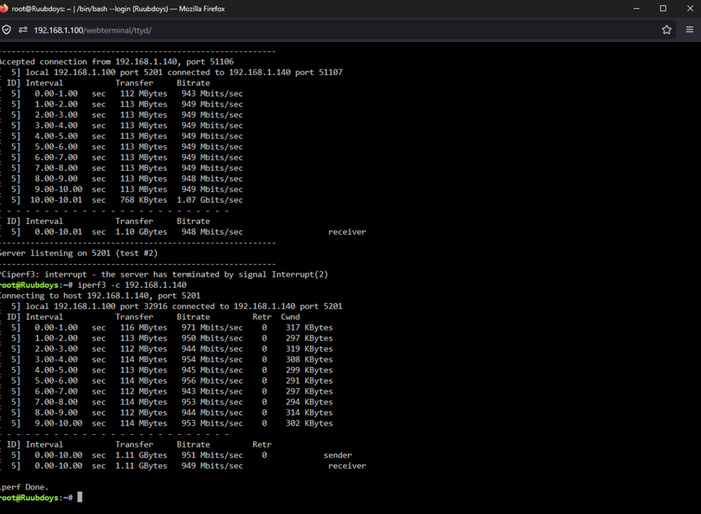

the files are going from ssd cache pool to my array, please find the iperf3 tests below as requested.
Iperf confirms it's a LAN problem; there's possibly some gigabit segment on the it, limiting the speed.
