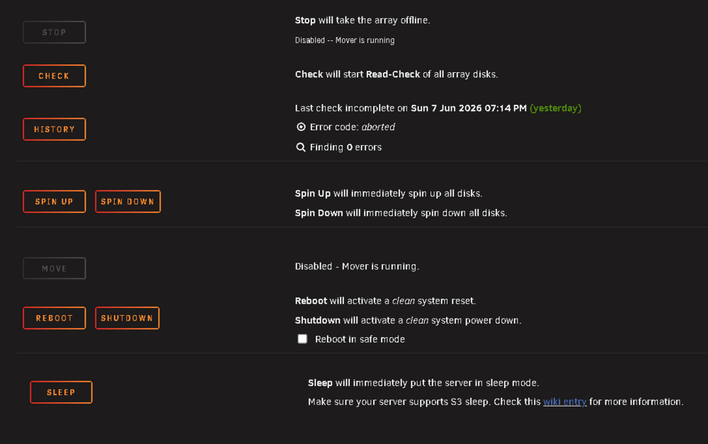

running the mover now as we speak
after starting the mover do i have todo anything or will it move things where they need to be already?
It will move the array files from appdata and system to cache, except for duplicates as mentioned. If a file is already on cache it won't be moved from the array. After mover finishes post new diagnostics and we will see if anything got left on the array.
Looks like everything got moved where it belongs.

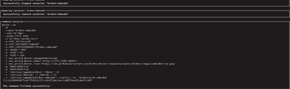

trying to figure out how to get docker run. the attatched explanation is a little confusing to me .
Click on the container icon to get its popup menu, select Edit
On 5/26/2017 at 12:03 PM, Squid said:
edit the application (you can always make any change and then change it back and hit "Apply" to get the docker run command to appear
i believe this is it

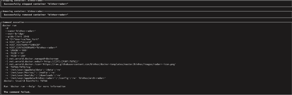

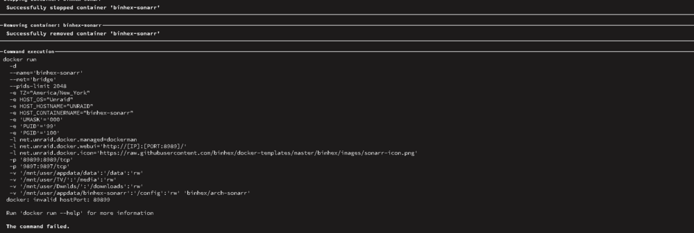

i changed the port number on both sonarr and radarr in order to get the docker run page to show up. afterwards i reinstalled then changed the ports back to their origional status.
You didn't have to "apply" the change, you just needed to make a change to enable the "Apply" button. Then you could have changed it back before doing "Apply".
And the changes you made failed due to the port change, but I assume when you changed them back they reinstalled OK.
In any case, you got the information I wanted to see. I will take a look at it.
yes when reinstalling it went back to its normal state before i made any changes to it .

except
17 minutes ago, trurl said:
docker run for sabnzbd
