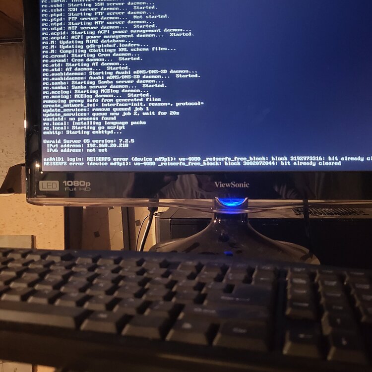

I hooked up a monitor to my server and this what it shows.

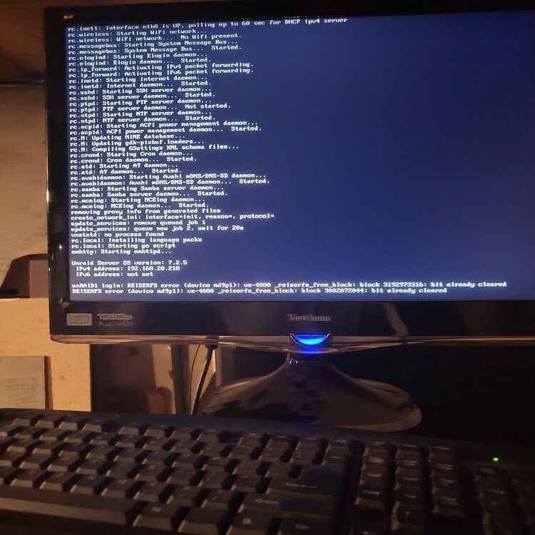

That last line in your photo suggests you have additional things to be concerned about.
Force reboot then
Attach Diagnostics ZIP to your NEXT post in this thread.
It does, it suggests filesystem issues on disk9, check filesystem on that disk after rebooting You will also need to think about moving on from reiserfs, Unraid 7.3 no longer supports it.

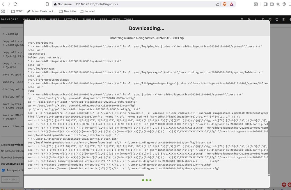

OK, as indicated above I have tried to get diagnostics but I don't know how much will be in the file. I will check the USB drive and also retry after I get the server running again.
I have already tried a CLI REBOOT and a console SHUTDOWN, neither of which worked. I will force a power down and see where that leaves me.
I was about halfway through converting this servers' 15 drives to xfs. Disk9 had just been cleared to an xfs disk in preparation for its own conversion to xfs. However, using the MOVE function of the Web Interface stopped actually moving files after just a few GB. It did keep on copying so all files remaining on it are duplicates. I had tried to use the Web Interface to DELETE them but that failed as did trying to do it from an SMB share. So I agree, it's file system is hosed and I was just going to let the reformat take care of it.
Hopefully back shortly with diagnostics.
