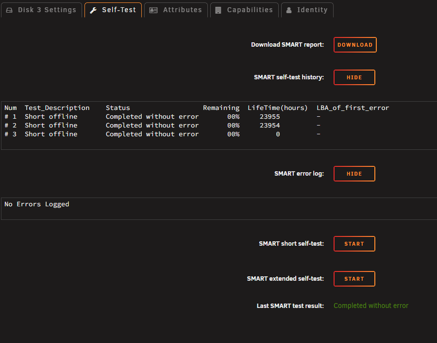

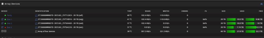

Any idea how to fix this then? Disk 3 is showing as disabled. When i hover over the red X a pop up message states "Device is Disabled, Contents Emulated." I can't re-enable the disk and the SMART test returns no errors. Thanks!
It took over 24 hours to run the extended SMART test. It completed without errors. I'll report back as I make progress. Thanks!
That seems a reasonable time. I normally expect it to take something between 1 and 1.5 hours per TB (these operations on modern large disks take a long time😃). Good indication of disk health that it completed without errors.
