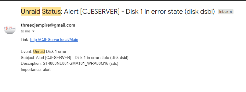

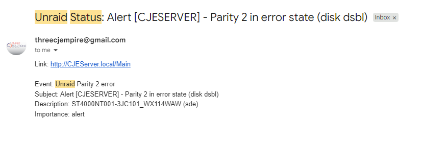

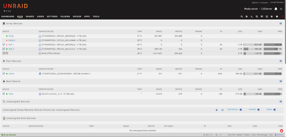

hi. my unraid system suddenly has errors on my drives. can anyone help me on what to do next? i have done xfs repair on disk1, the status said done. and now my files have returned and can be accessed from unraid and from windows explorer. what should i do to return parity2 and disk1 to the green dot state? hovering mouse over both X's says Parity - "Parity device is disabled. Click to spindown." and Disk1 - "Device is disabled. Contents emulated. Click to spindown".

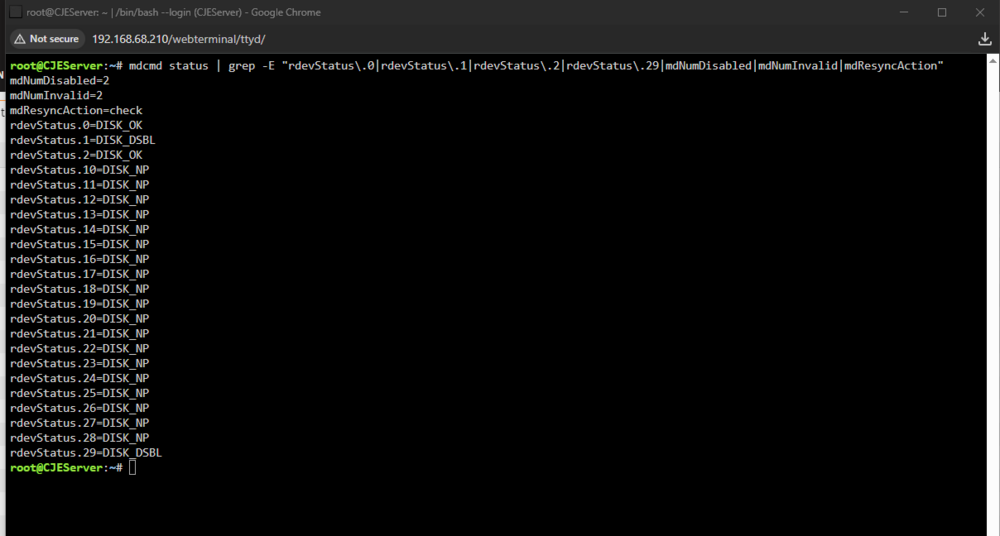

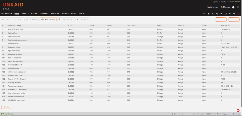

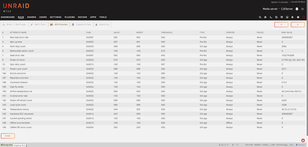

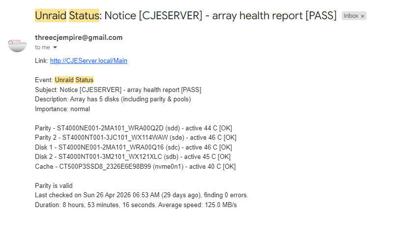

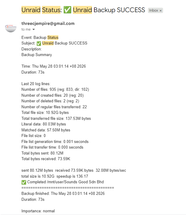

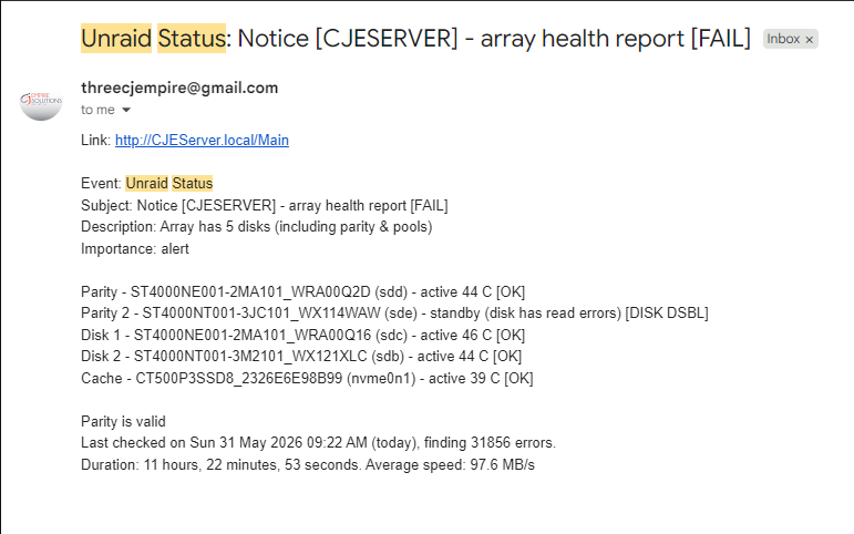

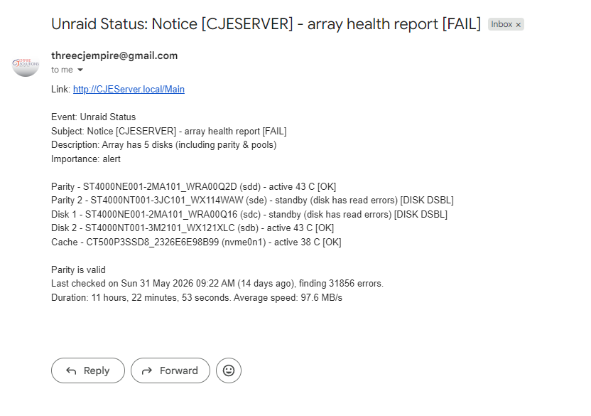

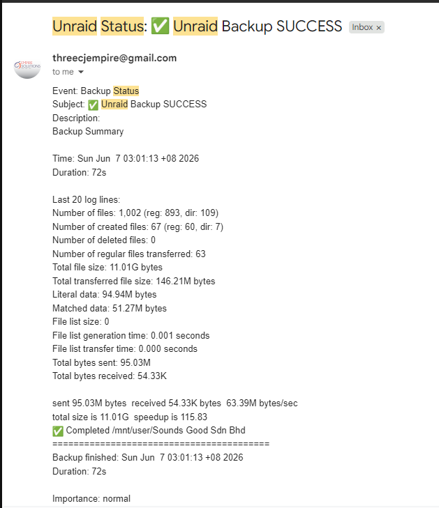

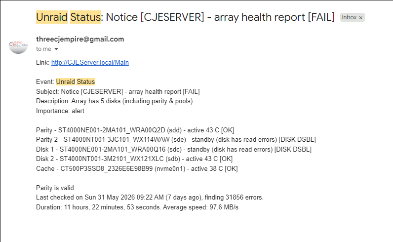

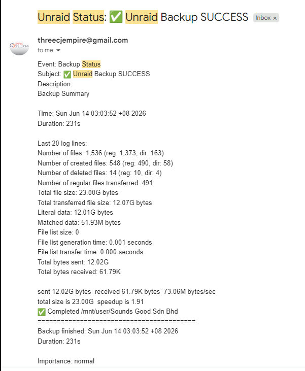

Edited by dimsum
added screenshot for chronology when the array passed and failed
Disks were already disabled at boot, so we can't see what happened, but they look healthy, so most likely a power/connection issue.
If you are happy with the emulated disk1 contents, check/replace cables for those disks, especially if they share something like a power splitter, then rebuild:
