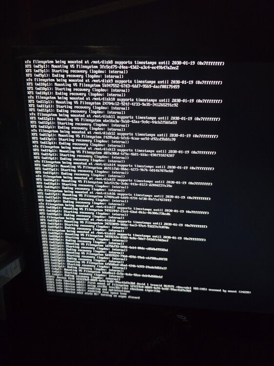

Oh and here is a picture of what I saw at the physical terminal while it was hard hung before I physically restarted it.

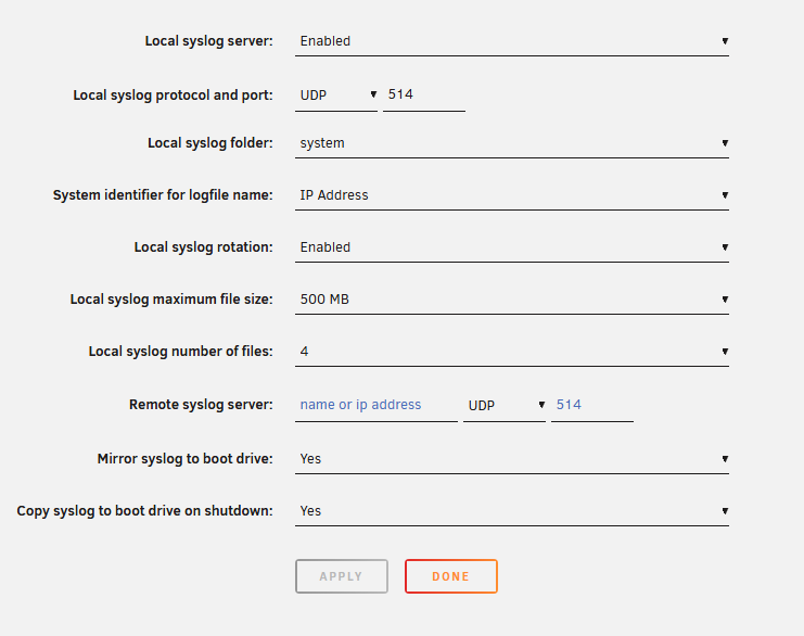

It was enabled for both of these logs
Post a screenshot of your syslog server settings.
Odd, somehow i must have set it to store in the isos directory, just changed that and increased the number of logs and size:
You must also set the Remote syslog server. If you want it to log to itself just put localhost.
After you actually get it storing syslog where you have it set to store them, you must actually get it from there and zip it to post it. It isn't included in Diagnostics.

Yeah I mean it's literally hanging at the end of the trace. I have replaced my HBA, and all of my power cables to my drives, and it just went down again. I will pull the logs tomorrow and share.
