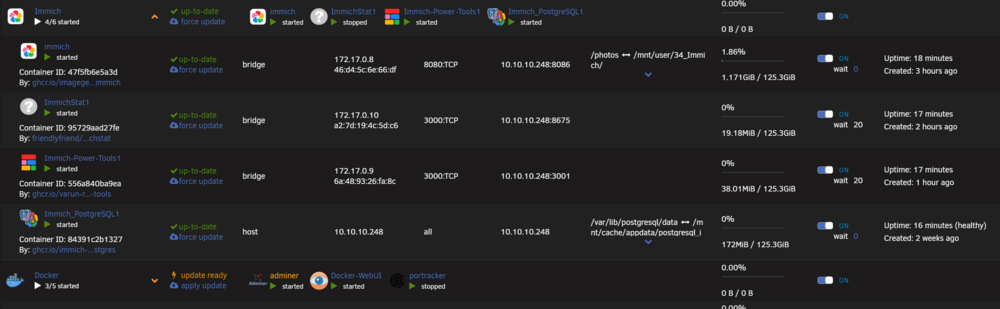

The Problem: I have now experienced lots of containers disapearing and some times reapearing again. Most of the time after a reboot I get missing containers and some orphaned ones. Also some times after a "bulk"-Update in Folderview3 (Update all) I get orphaned images afterwards.
Notice in the sreenshot that it shows 4/6 started, but it shows only 4. The missing ones will probably be Immich-redis and the second one I'm not to shure right now which one it should be.
Also notice the docker folder showing 3/5 started, but only 3 container showed. One of the missing ones will be this one: grafik.png

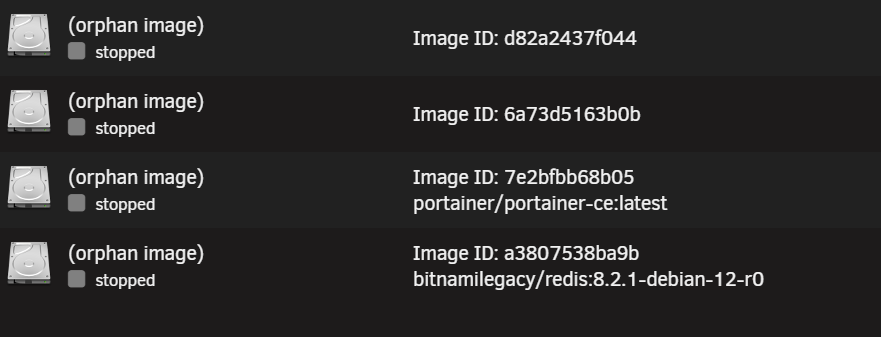

And there are more orphans by the way:
Whai I wxperience now for the first time is that the first 2 of them don't even show the name anymore, so I have no idea which ones are missing.
I can now delete the orphans and reinstall them, but I allways get an error:
docker: Error response from daemon: Conflict. The container name "/PortainerCE" is already in use by container "5d1124ae90bacea5f5725436caa80045b1e40cb755179f1ead0639029dfde56c". You have to remove (or rename) that container to be able to reuse that name.
Run 'docker run --help' for more information
The command failed.
I can now rename and install it as PortainerCE1, but then it is not in the correct Folder anymore and so on...
And sometimes a "lost" Container magicly reapears again after a restart, so it hapened with Luckybackup, of which I duddenly had 2, Luckibackup and Luckibackup1 (but normally I get more orphans after a reboot).

Docker folder with native zfs driver is not recommended and known to have multiple issues, I would recommend recreating that as a docker image, even other docker folders can have strange issues in my experience, but if you prefer to keep the folder, recreate it using the overlay2 driver.
https://docs.unraid.net/unraid-os/troubleshooting/common-issues/docker-troubleshooting/#re-creating-the-docker-image-file
Then:
https://docs.unraid.net/unraid-os/troubleshooting/common-issues/docker-troubleshooting/#reinstalling-docker-applications
Also see below if you have any custom docker networks:
https://docs.unraid.net/unraid-os/troubleshooting/common-issues/docker-troubleshooting/#restoring-docker-custom-networks
