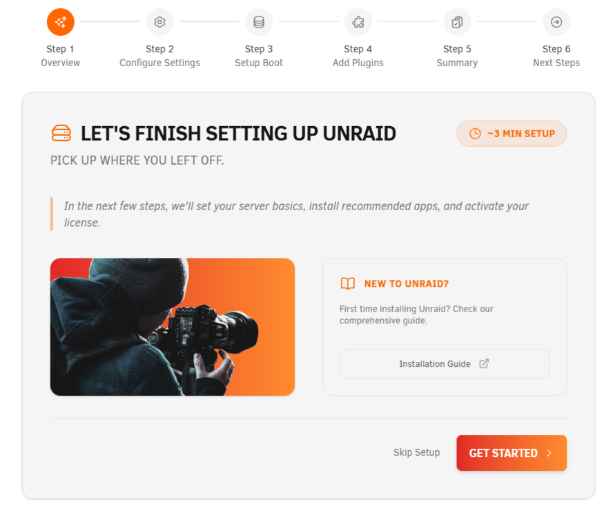

twice now my new server (within trial period) has stopped working nominally and I can no longer access the shares or web UI.
All I can see is an onboarding wizard although initial setup (users, shares etc.) is already complete and the server had been working for about week.
Skipping only restarts the wizard and it also fails to complete, beginning another loop.
A forced reboot fixed it for a day or two but then the problem reappeared.
Any help would be appreciated.
Thank you!
Edited by MJW
That suggests a problem with the flash drive, enable the syslog server and set it to save to a share, then post that after it happens again.
