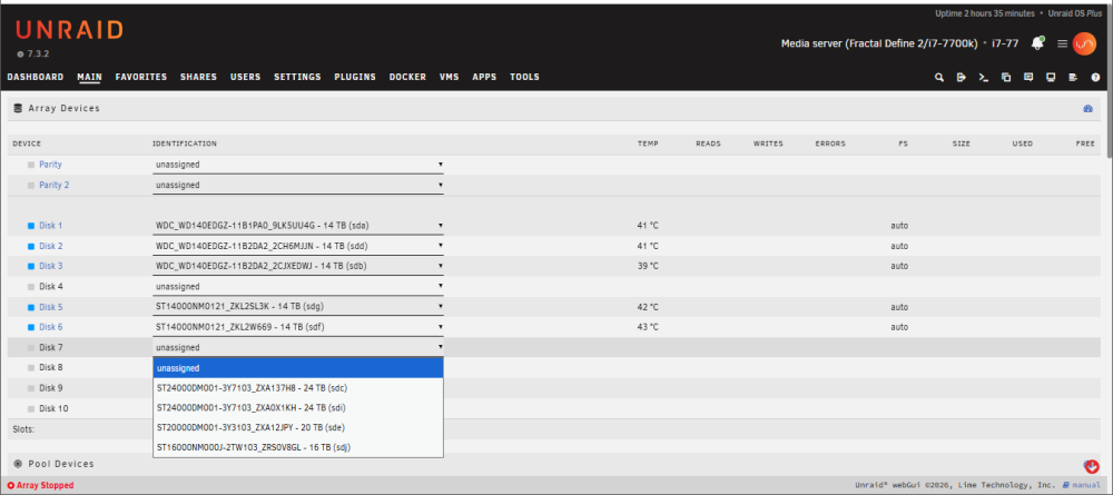

EDIT: The two 24's, and the 16tb and 20tb, all seem to be 'parity' when trying to add them as data drives and starting the array.

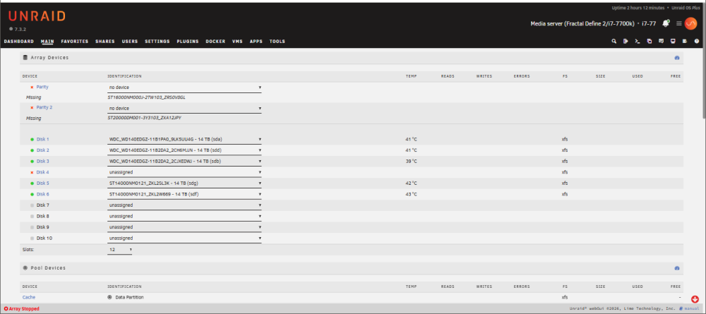

The situation OP is currently in is all of their disks are shown an "Unmountable" and they are not sure which two are the parity disks.
The plan was to attempt to identify which two disks were going to be reported as unmountable to determine which two disks were parity, assign them back to P1 and P2 slots. However we ran into a snag, due to issues with disk assignments missing (old super.dat) it wasnt possible to start the array to use unassigned devices to mount the disks with the RO flag.
Plan B was to invaldiate parity by mounting all the disks to the array slots only, after running tools > new config, and then simply identify which two disks didnt mount/have a valid filesystem. Ran into another issue where all of their disks are showing as unmountable.
The goal now is to fix the filesystems on the disks that had filesystems and rebuild parity as parity was invalidated.
Disks, 1,2,3,5,6 are known XFS disks,
Disks 4,7,8,9 are the unknown disks.

I attached screenshots of OP's setup in my previous comment, all 14TB disks are known data disks, it's a matter of finding out which of the two 24TB, the 20TB, and the 16TB disks were data disks or parity disks.
The 14TB disks however are currently unmountable, how do we correct these so we can mount them?
From there how can we identify, of the 4 remaining disks, which two had a valid filesystem vs just being a parity disk?
Edited by MowMdown

This is the layout I 'THINK" the system was before the crash. Screenshots are after the new config, with preserve data on all drives. I checked the boxes for "maintenance mode" and Parity is valid".
So I should start and stop the array, then 'UNASSIGN" the two 'data' drives (16 & 20 that were wrongly put back as parity by the old backup OS) leaving the parity drives in place, then RESTART the array with those two drives out, and post diagnostics?
