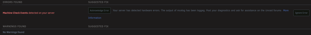

Friday at 06:39 PM5 days Author I checked Fix Common Problems this morning and this showed up.Making a Thumbdrive for memtest.
