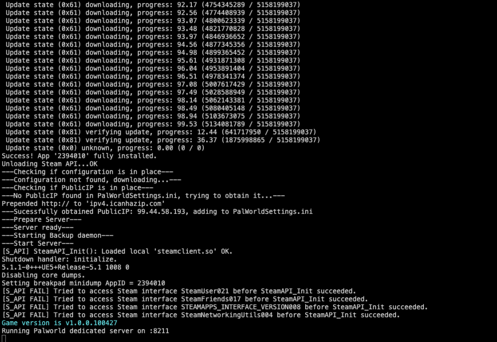

I have downloaded Palword from Apps with no modifications.
Gave it time to download and watched it in the logs -- no issues.
The Docker is up and running.
I have stopped it to change the ini files:
    hoping to change the Server Name, Password, Admin Password -- then planned on logging in.

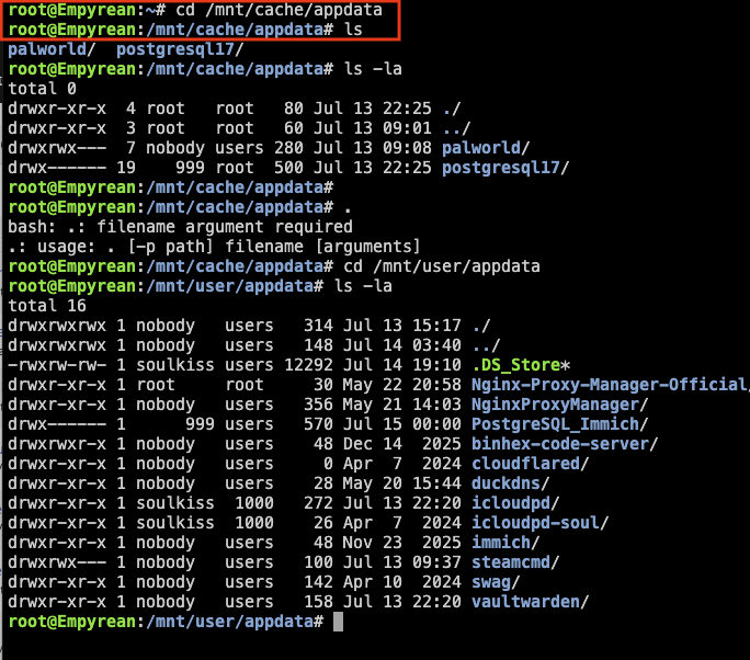

Well, I went to where the files should be and I am baffled.
/mnt/cache/appdata/palworld
I cannot seem to find this folder.

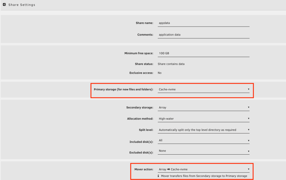

I do fave the shares set for primary storage to Cache-nvme -- and other apps do appear here get moved appropriately, I think.
Secondary storage is set to Array
Mover action is set to Array -> Cache-nvme
terminal of :mnt:cache-nvme:appdata.png
terminal of :mnt:cache:appdata.png

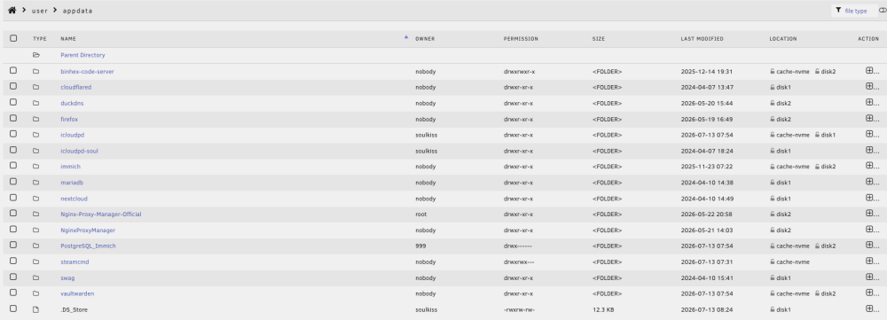

Do you mean that you want appdata to span both pools? Appdata share should never have mover enabled, unless you are temporarily moving data with Docker disabled.

Have you tried looking under /mnt/user/appdata/palworld ? That is the User Share path and should locate it regardless of what drive it is located on.

If you don't actually have a pool named cache, /mnt/cache is a path in rootfs, the RAM reserved for the OS. Anything stored there won't persist.
Check the host volume paths for the containers.
Its not showing up -- yet the docker says its running but I can not find or access the files.

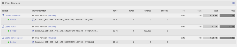

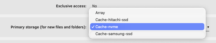

In the share setting it only gives 3 options of the 3 ssds I have on the rig.
I want them on the nvme ssd and it shows up as cache-nvme.

I was told to consider erasing all drives and just to reinstall Unraid after; there is not much on the system yet as I am trying to learn.
But I have been puzzled as to why the cache-nvme; no option for just cache

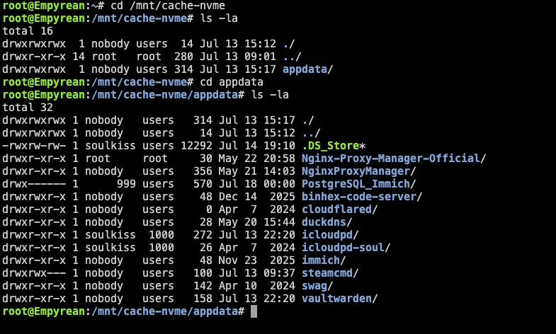

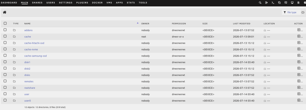

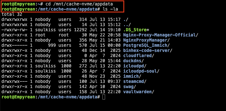

I am able to find the /mnt/cache-nvme -- in terminal but no listing of PalWorld
This is why I am baffled. Should I have placed it in the /mnt/cache-nvme/appdata in the Edit of the Docker instead of what is defaulted: /mnt/cache/appdata

If you do not have a pool called ‘cache’ then the location /mnt/cache/appdata is only in RAM, not on a physical device, and its contents will not survive a reboot. If a container has that location in a disk mapping it will not work correctly if you do not have a pool called ‘cache’.
It is better to use the location /mnt/user/appdata as that is the User Shard path that works regardless of which drive the ‘appdata’ share is located on.

You do not have a disk pool named “cache” and your “ServerFiles” is writing to /mnt/cache/appdata which should be /mnt/cache-nvme/appdata
However as Itimpi said you should instead use /mnt/user/… instead of disk names and let Unraid manage it.

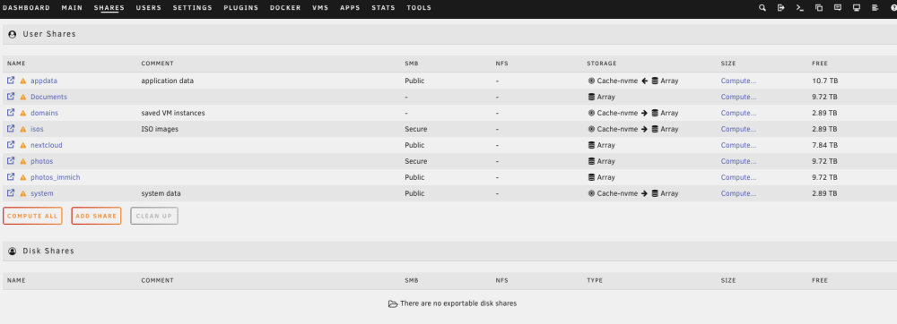

I did notice that on the storage of the Shares -- the arrow for the Array points back to the Cache-nvme where the other have the arrow reversed, could this be the issue?
The mover direction is correct. For performance reasons you normally want appdata files to end up on a pool rather than the main array.
The 'system' share should also be like that as you want its contents on a pool for performance reasons. Note that you need to have the docker and VM services disabled if you want mover to move files for the 'system share' as those services keep files open while they are enabled which stops them being moved.
If you run VMs then you may also want the 'domains' share set up like - again for performance reasons although in this case size considerations of the disk image files used by VMs may make it more awkward.
When you have any those shares purely on a pool you may want to remove the Secondary Storage of 'array' option (which then removes the mover option) and then check that Exclusive shares are enabled under Settings->Global Share settings as this enhances performance for accessing files that are only on a pool and set to stay that way.
There is the appdata backup plugin available for periodically moving the contents of those shares to a backup location on the main array.
