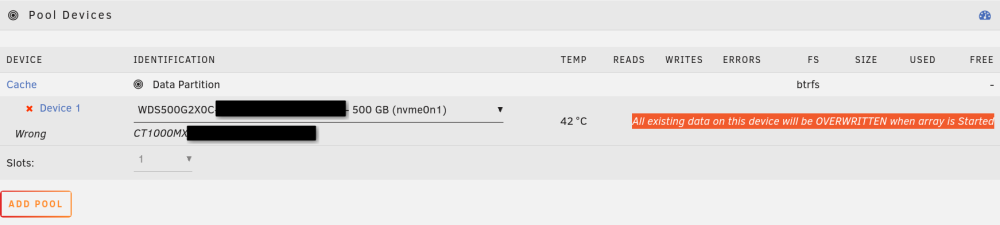

Now when i try to select the nvme drive in unraid the gui says "All existing data on this device will be OVERWRITTEN when array is Started".
Is it possible to include the prepared nvme drive into my cache pool and replace the old one without the data being erased at array start?
Sounds like you're assigning it at the wrong place since that would only show for a drive that's in the array, not in a pool.
it is definitely the cache pool
rsync won't give a clone.
You may have to New Config to get the new drive accepted with its contents.
You can't just change the drive assigned to the pool, click on the pool name, delete it entirely, then create it again with the new disk.
If once that's done and the array is started it asks to format then come back.
Click the pool name, click remove pool (not erase)
Then create a new pool using the same old name.
Assign the disk and start the array
This worked like a charm. Thanks!
