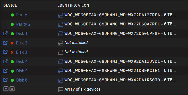

Checked the SATA-connectors, and now the two drives are not recognized anymore:
Tried a few times but no luck. They Sounds and feel like they have power...
I ordered a new mSAS to SATA Cabel. Hopefully that will fix it.

Not for these drives, but I use a Molex adapter.
Since they seem like they have power, I don't think that's the issue.
