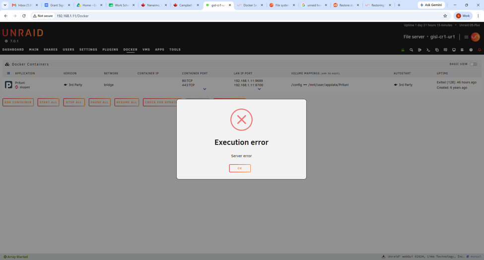

Sunday at 10:40 PM1 day Hi, folks.I'm currently working through a problem with my unRAID server. It started with a drive that had read errors. I ordered and installed a replacement drive, but had to shut down the system to do it as my system is not hot-swappable. When It came back up, the array status went good, but Drive 1 was not mountable. So, I went through the process of checking and fixing the file system (deleting dirty log). After this, the array came up properly, and I was able to access shares via SMB. However, while my Docker container (Pritunl) was visible, it wouldn't start. So, I tried restoring both the template (xml) and container (tar.gz) through Community Applications appdata backup. However, while the logs indicate success, Pritunl still won't start.I tried restoring from multiple backups to see if that made any difference, but there was no difference. Any assistance would be very much appreciated.Diagnostics attached.Thanks,Shaun gisl-cr1-ur1-diagnostics-20260719-1523.zip
