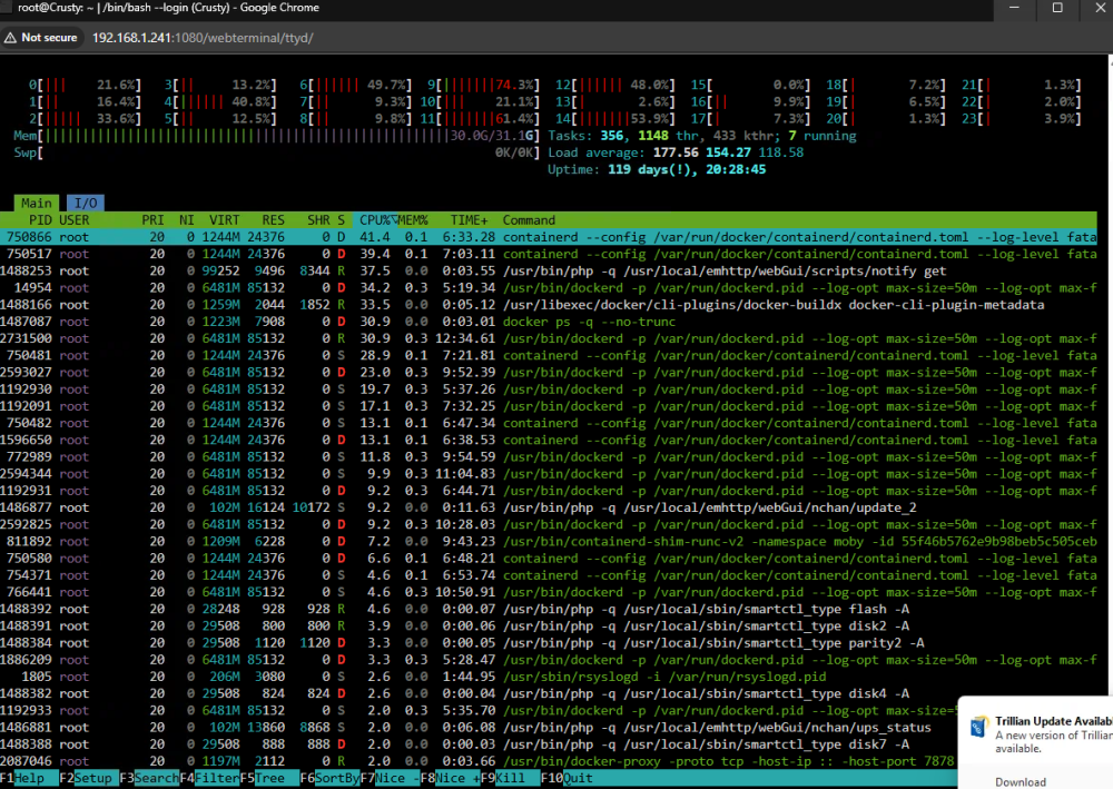

Over the weekend my server became unresponsive. It eventually opened the gui and i saw the CPU was 100%. I was able to run htop and this is what it showed.
I tried to restart but it never came back up. Seems the USB drive is dead. I tried downloading the Boot Device Backup from Connect, first coupel times it gave me an error. Then it downloaded a backup, but when i used it to create the USB, it didn't install any data. Theres just an empty "syslinux" folder and the normal files on the root of the usb. No Config folder nor EFI folder. Does unraid connect have a bad backup? it says its from just 3 days ago.
