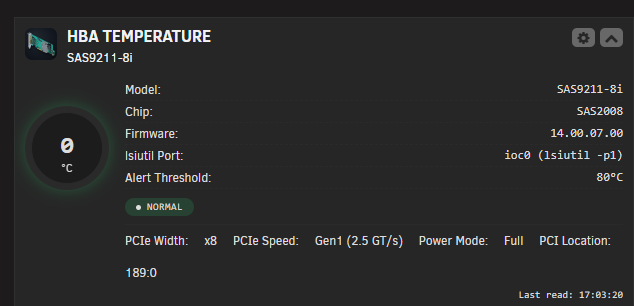

I'm looking at various plugin and information about my server. It is a Dell Precision 5820 with a Xeon W-2275. According to specs, it has all PCIE Gen 3 slots. But looking at lspci output and various other plugin like hbaviewer and GPUStats, they are reporting connected as Gen1 speed but Gen 3 available. Does anyone know how to enable it to be on Gen 3? Both card connected are Gen3.

9 minutes ago, Nodiaque said:
SAS HBA
That's a PCIe2 card, working as such. Quadro might get downgraded because of it, or you have to check BIOS settings
Edited by Kilrah
So I got sold something that isn't what spec on the seller page if I understand correctly, cause they say it's a PCIe Gen 3 x8. But if it's gen 2, why does it connect at gen1 speed?
Edited by Nodiaque
SAS2008 is PCIe2 so if it was listed as Gen3 that'd have been a listing error
Edited by Kilrah
I'm unsure if it's really an error, the whole page on amazon speak of gen 3, even the title say gen 3. It's been far too long for me to return. But shouldn't it show gen 2 and not gen 1?
Oh I don't contradict your information, I did found out the broadcom information about the LSI SAS 2008 which says it's PCIe Gen 2 (https://docs.broadcom.com/doc/12352283)
So it's the plugin that is in the wrong then, cause it shows as 2.5gbps
But the NVidia is downgraded to PCI gen 1 though
LnkSta: Speed 2.5GT/s (downgraded), Width x16
PCIe devices like GPUs downgrade their gen when not in use.
Edited by MowMdown
Ah! Good to know
