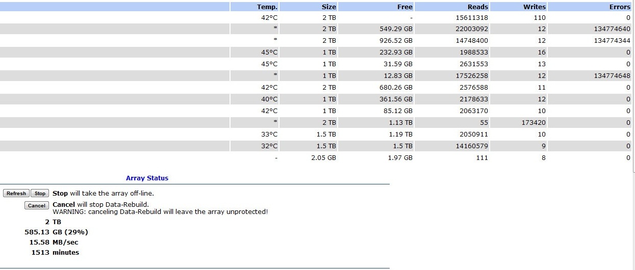

I seem to be having major issues with the rebuild of a new disk.
It was in the middle of a disk replace (#1) when the power got cut off.
I restarted the server (and disk replace #2) and now I woke up this morning to (see attached picture)...
It looks like are write errors 134774640 and counting) on disk 2,3 & 5 and all files on these disks are missing.
I don't want to halt the current rebuild but is the data on these lost? Or can I wait for the disk replace to complete and rebuild parity so I can get my files back?
here is a snippet of the log

OK I Stopped the Rebuild at 31%
Rebooted and Started (w/o rebuild)
I am going to give it another go but if I get more errors like above - does anyone have any steps to solve it?

The second time completed and now it looks like both the Parity and #2 (no files again) have errors (different drives that previous attempts!) so maybe it is the power.
It is currently attempting to correct errors by writing corrected parity. hope i get no errors and my files back.
