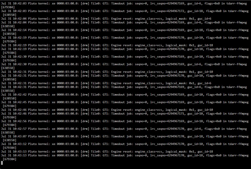

I had a ARC Pro B70 in the system, but every 24hr the card would disable itself. I put an ARC A770 in the system and it run perfectly fine with no issues. I then put a ARC B580 in and I am getting a bunch of timedout errors. I only see the error when using a gpu using the Intel XE drivers. Any Idea?
pluto-diagnostics-20260731-1035.zip

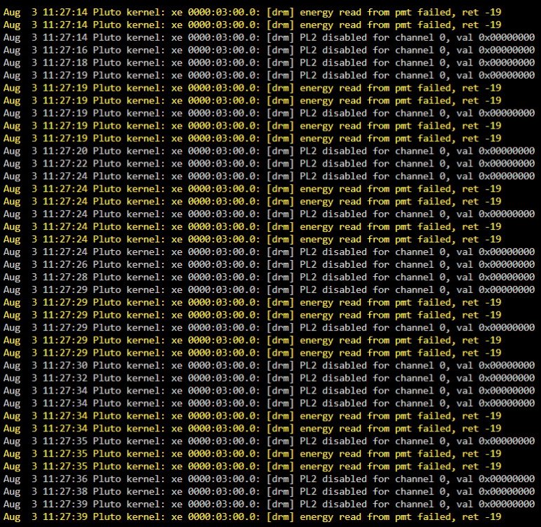

UPDATE:
I am now getting this error in tandem
