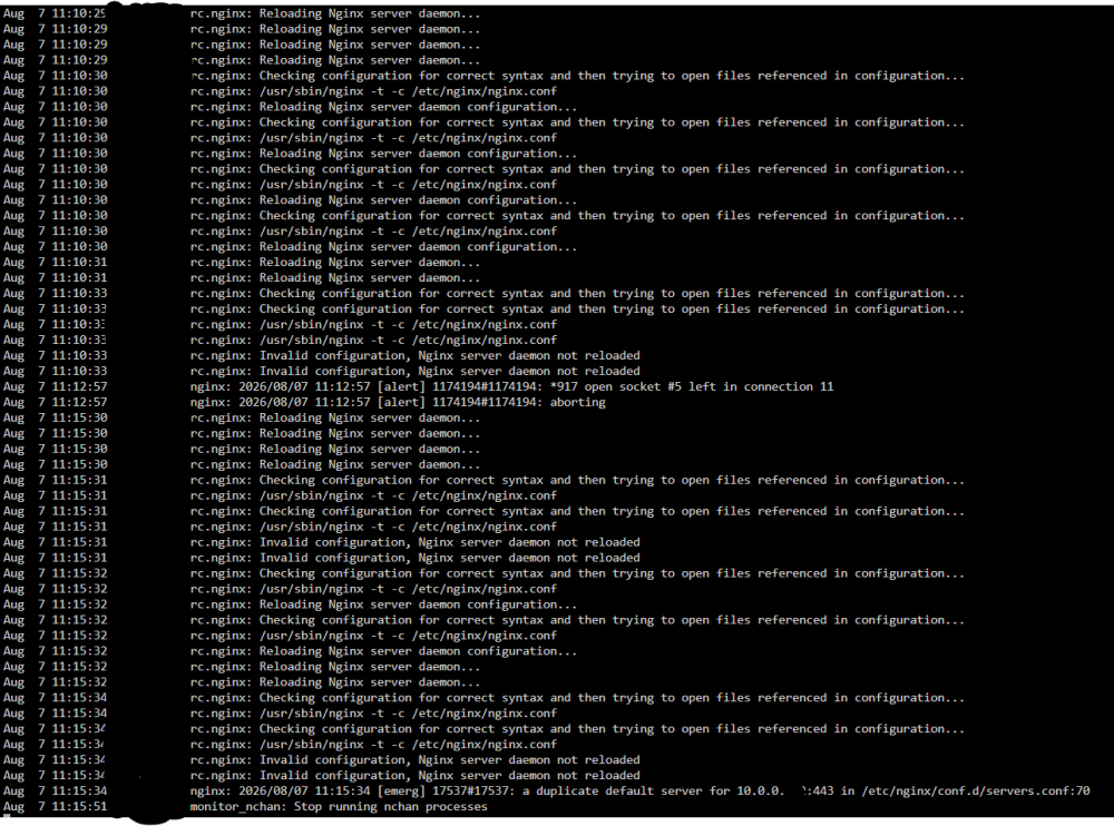

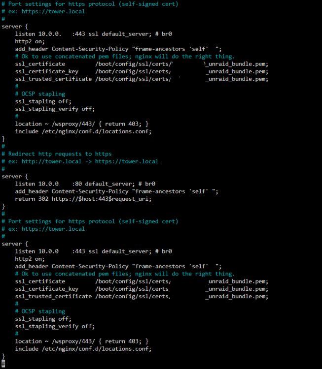

I keep getting this Nginx [emerg] warning that "a duplicate default server for x.x.x.x:443 in /etc/nginx/conf.d/servers.conf:70" and indeed if I check servers.conf there are two default server entries in there for the same address and same port.
I've tried removing one manually, but some service keeps adding it again and I can't figure out what.

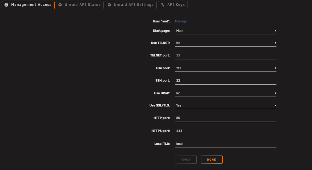

Strangely, even while reporting that the nginx server could no reload, I still have Unraid Connect access to the server and my Dockers (including Guacamole, Plex, etc) at the moment, but occasionally (recent example being the afternoon/evening of the 6th of August) I lose all but local access from the server - no Guacamole, no Plex, no Unraid Connect access.
When that happens and I access the server locally via CLI I am able to ping local devices, but am unable to ping the Default Gateway or anything on the internet (8.8.8.8, etc). Rebooting the server often doesn't resolve the issue, so sometimes I just have to wait until Guacamole, Plex and Unraid Connect access is suddenly restored for reasons not yet know to me (like later in the evening of the 6th of August)

I can confirm this issue on two separate Unraid 7.3.2 servers, and it appears directly associated with the Unraid API/Connect service.
Main server (“Tower”):
  • Unraid API/Connect 4.37.0
  • Large numbers of simultaneous rc.nginx reload operations occurred.
  • /etc/nginx/conf.d/servers.conf acquired a complete duplicate set of self-signed HTTPS, HTTP redirect, and CA-signed HTTPS server blocks.
  • nginx -t then failed with duplicate default server.
  • The WebGUI became unreachable.
  • Stopping unraid-api, removing only the complete duplicated blocks, and restarting nginx restored the local WebGUI.
Test server (“Tower2”):
  • Upgraded to Unraid API/Connect 4.37.1 (4.37.1+d8801361).
  • It initially appeared stable, with API uptime of approximately 47 hours and zero PM2 restarts.
  • It then developed the identical configuration corruption.
  • The syslog contained 15,412 entries matching rc.nginx.
  • Multiple nginx reload attempts were occurring at the same timestamps.
  • nginx -t failed with:
a duplicate default server for [LAN IP]:2443 in /etc/nginx/conf.d/servers.conf:91
  • servers.conf again contained one complete duplicated set of the same three server blocks.
  • I ran unraid-api stop. The rc.nginx count was 15,412 before waiting and remained exactly 15,412 after 10 seconds, indicating that the reload storm stopped immediately with the API.
  • After preserving the logs and corrupted configuration, I removed only the complete duplicate block. nginx -t succeeded, and the local WebGUI worked again without restarting nginx.
This has now reproduced with both 4.37.0 and 4.37.1 on two different Unraid 7.3.2 servers. Version 4.37.1 therefore does not appear to fix it.
