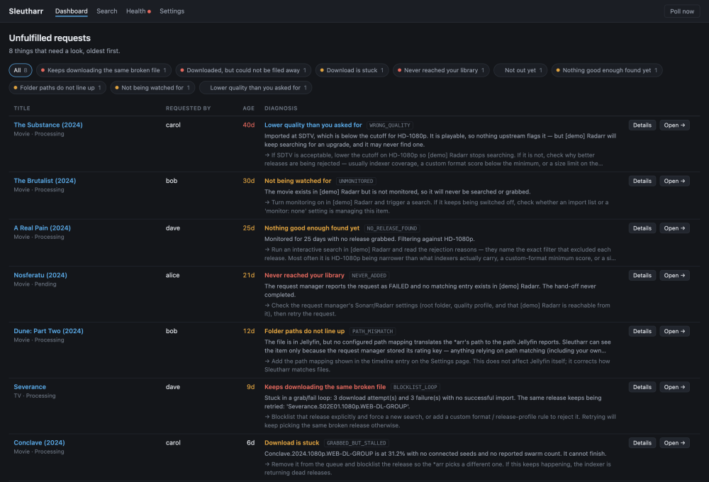

Sleutharr answers one question: I requested this — where did it die?
It reads your request manager, Sonarr/Radarr, your download client and your media server, stitches one request into a single timeline across all of them, and tells you which link in the chain broke. Instead of opening five web UIs and correlating timestamps by hand, you get a sentence: this was never added to Radarr, your indexers are down, it downloaded but the import failed with this exact error, it is in Plex but your path mapping does not reach it.

Add your request manager on the Settings page and press Find my other services — it reads the rest of your setup out of it rather than making you type it all in again.
It is read-only
Sleutharr does not touch your files and does not change your setup. There are exactly three actions that write anything, each behind a confirmation and each logged:
  • Remove & blocklist — goes through Sonarr/Radarr rather than straight to the download client, so the *arr blocklists the release, clears its own queue and history, and searches for a replacement itself.
  • Retry the request — asks the request manager to push it to Sonarr/Radarr again. Seerr, Overseerr and Jellyseerr only; Ombi has no retry endpoint, so the button does not appear there rather than pretending it will work.
  • Search again — off by default. Removing with blocklist already makes the *arr search, so this is redundant most of the time; it exists for the case where nothing was ever grabbed at all. Enable it in Settings if you want it.
Nothing happens automatically. There is no auto-remediation and no setting that turns one on.
