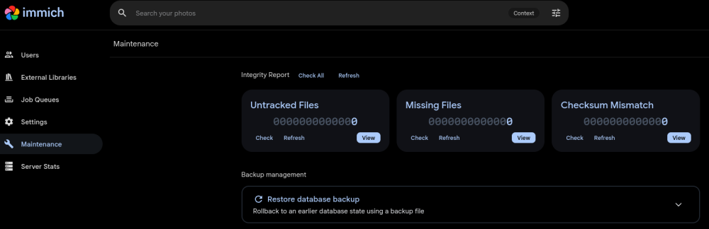

Unfortunately I restarted the Server before saving logs. The only proof of the missing data I can find is within the immich application. These ,now missing, Pictures and videos were displayed in Immich as an external library and you can see in the screenshot that the daily backup immich does from its database is considerably smaller because suddenly all the files are missing.

Here you can see the Screenshot from the "Immich" application. It shows the time and size of the automated Backup of the Immich Database. You can see , that sometime between the 05.08. and the 06.08 that the size of the Backupdatabase decreased from 797,7 mb to 453,4 mb. I think this in direct connection with the missing data on my network share.

You may need to upgrade to immich v3 which requires doing a modification to the database container tag but immich will tell you if photos are missing
I do not know if this is an Immich or an Unraid problem but I do not think, that updating immich would help, because the files are not in the Share anymore. They may be gone or just moved somewhere. But I have not found them yet. But an update of Immich will not bring back the files on my share I think
Well if the photos are gone, due to being moved or deleted outside of immich, it will be able to detect the missing photos using this feature. If immich doesn't see any missing files there is a chance I would think that they were in fact deleted from immich itself.
Edited by MowMdown
2 minutes ago, MowMdown said:
Well if the photos are gone, due to being deleted outside of immich, it will be able to detect the missing photos using this feature. If immich doesn't see any missing files there is a chance I would think that they were in fact deleted.
Since which immich Version is the "Find missing files" available? I am missing that feature in Version 2.7.5 . Does anyone know how to find out, what deleted the files, if they are deleted. We are talking about hundreds of GB of files. I just dont understand how they can just disappear especially because other file types remain in the Share at the same place as the missing files.

However my advice still stands, Update immich to v3 which will do a comparison to photos on disk vs what the database thinks exists to know for sure if any are missing. Otherwise assume they were user deleted.
