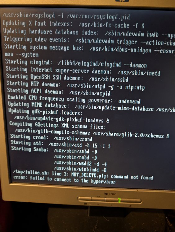

Boot Failure
I am getting an error about being unable to connect the hypervisor on boot and it halts. I cannot get into the GUI.
Are you running Unraid as a VM?
You can try redoing the flash drive, backup the current one first and then recreate it using the USB tool and just restore the bare minimum, like the key, super.dat and the pools folder for the assignments, also copy the docker user templates folder (\config\plugins\dockerMan\templates-user), if all works you can then reconfigure the server or try restoring a few config files at a time from the backup to see if you can find the culprit.
