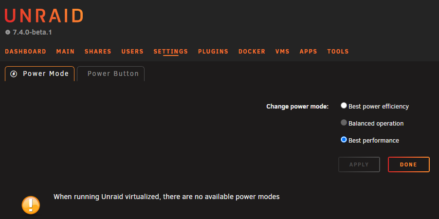

August 15Aug 15 Updated my non-production "Backup" box to 7.40-beta.1 (no issues encountered during the upgrade).One minor issue present, when I click on "Settings" -> "Power Options", a warning to say "When running Unraid virtualized, there are no available power modes" is displayed.This Server is 100% physical (Intel i5-14500T, 16GB DDR5, Asrock ASRock B760M Steel Legend WiFi with its latest BIOS release - 14.02, mixture of HDDs and SSDs).(I have set the new "Power Button" setting to "Do Nothing" and can confirm this works.)I've also attached diagnostics. backup-diagnostics-20260815-1031.zip
August 15Aug 15 16 minutes ago, PPH said:a warning to say "When running Unraid virtualized, there are no available power modes" is displayedI believe that warning always shows; it doesn't try to detect whether you are actually virtualizing Unraid or not.
August 15Aug 15 3 hours ago, JorgeB said:I believe that warning always shows; it doesn't try to detect whether you are actually virtualizing Unraid or not.Thanks Jorge,Just thought I would highlight as it doesn't display this on version 7.3.2.

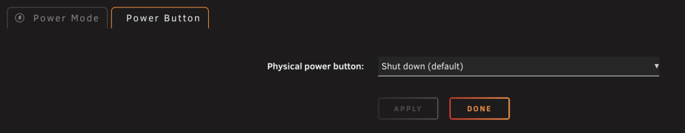

August 15Aug 15 I don't have that "Power Button"-tab. Too old machine? ;)Pressing once does the clean power off at least. Edited August 15Aug 15 by Niklas

August 17Aug 17 On 8/14/2026 at 12:07 PM, SpencerJ said:Configurable power-button behavior — Shut down, Reboot, or Do nothing, under Settings → Power Options. Good news for anyone who's had a case bump take their server down.Neither of my physical servers have a "power button" tab within power settings 😳 Edited August 17Aug 17 by MowMdown
August 18Aug 18 6 hours ago, MowMdown said:Neither of my physical servers have a "power button" tab within power settings 😳On 8/15/2026 at 7:38 AM, Niklas said:I don't have that "Power Button"-tab. Too old machine? ;)Pressing once does the clean power off at least.Odd! There are no conditionals on this page, if the server has rebooted into 7.4.0-beta.1 it should be there. Please post the issue here https://product.unraid.net/b/unraid-os-prerelease-bugs-feedback and include your diagnostics so we can troubleshoot

August 18Aug 18 10 hours ago, ljm42 said:Odd! There are no conditionals on this page, if the server has rebooted into 7.4.0-beta.1 it should be there. Please post the issue here https://product.unraid.net/b/unraid-os-prerelease-bugs-feedback and include your diagnostics so we can troubleshootI've deduced it to one of my installed plugins, just not sure which one yet, but I don't have many installed so finding the culprit shouldn't be difficult..Edit: The problematic plugin is the "Dynamix System Buttons" plugin (probably should blacklist this plugin on 7.4.0) Edited August 18Aug 18 by MowMdown
August 18Aug 18 On 8/15/2026 at 2:40 AM, PPH said:Updated my non-production "Backup" box to 7.40-beta.1 (no issues encountered during the upgrade).One minor issue present, when I click on "Settings" -> "Power Options", a warning to say "When running Unraid virtualized, there are no available power modes" is displayed.This Server is 100% physical (Intel i5-14500T, 16GB DDR5, Asrock ASRock B760M Steel Legend WiFi with its latest BIOS release - 14.02, mixture of HDDs and SSDs).(I have set the new "Power Button" setting to "Do Nothing" and can confirm this works.)Thanks, this is definitely a bug. I reported it here https://product.unraid.net/p/power-options-incorrectly-displays-virtualized-system-warning-on-bare-metal-servers?b=unraid-os-prerelease-bugs-feedback
August 18Aug 18 21 hours ago, MowMdown said:Neither of my physical servers have a "power button" tab within power settings 😳3 hours ago, MowMdown said:Edit: The problematic plugin is the "Dynamix System Buttons" plugin (probably should blacklist this plugin on 7.4.0)Confirmed, that plugin has a conflict. Should be fixable, I reported it https://product.unraid.net/p/dynamix-system-buttons-plugin-removes-the-power-button-tab-from-power-options?b=unraid-os-prerelease-bugs-feedback
