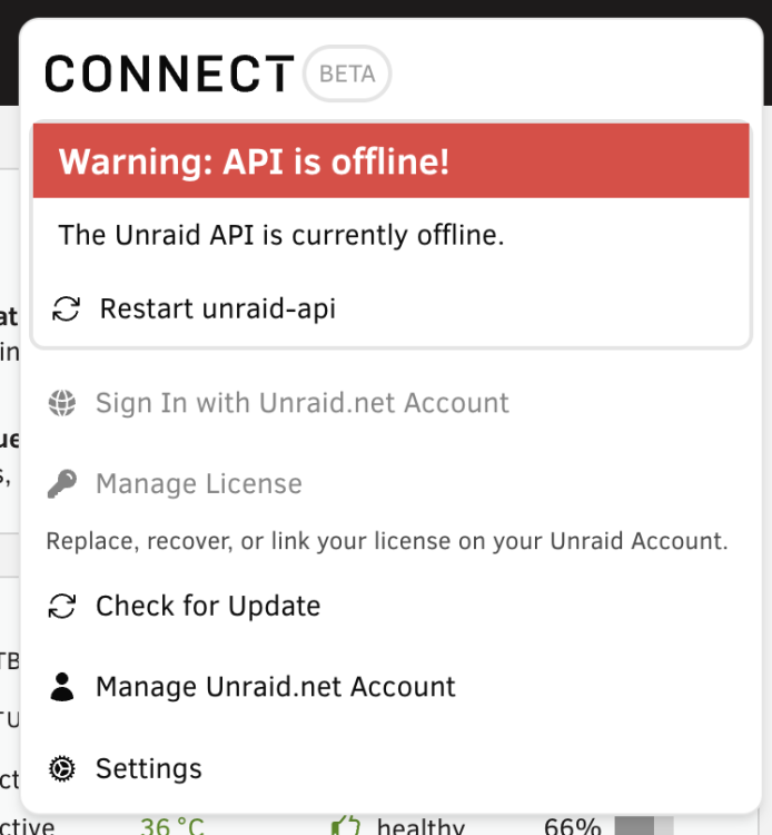

This is what I am seeing on the profile popup.

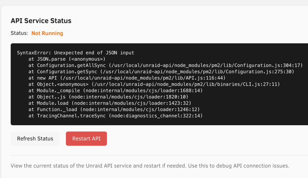

This is what I am seeing on the settings page.
I tried restarting the API multiple times, I removed and installed the plugin multiple times, but for some reason is it not working anymore. Any clue as to why the JSON input is invalid and from which JSON files this coming?
I check all the JSON files in the boot/config/plugins/dynamix.my.servers/configs folder, but they were all valid JSON.

You can try this (you may need to reconfigure some Connect options/settings if they were already set)
Uninstall the Connect plugin first (Plugins tab)
Then open a terminal window and type or copy/paste
unraid-api stop
mv /boot/config/plugins/dynamix.my.servers/ /boot/config/plugins/dynamix.my.servers.bak/
unraid-api start
Then reinstall the Connect plugin and try again
The uninstall plugin scripts keeps hanging on an unraid-api command. I ended up removing all the plugin config files and restarted the server. After that I installed the plugin, it worked for a week and now back to this problem
