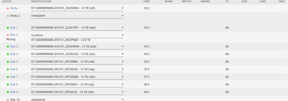

I work with a local production company and I helped build a server for our footage. and the server was running well for the last two years until recently a few days ago the server was missing files of footage. So i tried to reboot the server and all of a sudden when I tried turning it back on, it powered on but nothing showed up. As I was waiting it to boot up I was hearing a lot of noise coming from a drive. And I found out that there was a drive that had failed. Should be a simple problem to fix, only there is an even bigger problem. With that drive failing, my parity drive has all been disabled. I ran tests (currently running extended smart self test) and it seemed that the parity is healthy but for some reason its disabled and I have no way of starting the array. Is there any solution anybody could give me to help get the server back up? Even if I have to lose some data i just need it back up, I cant afford to lose all the data.

Are you sure disk2 is really dead? Is it still plugged in? I don't see it in those diagnostics. See if you can reconnect it and check if you can see it in BIOS.
I already switched it out because at first the server wasn't booting up all they way while it was plugged in and then I unplugged that drive and the server booted up alright. Then while I was waiting for the new drive to come in that I had bought I tried booting up the server again with the drive plugged in and it actually booted up but it still said it was missing. while the drive was plugged in also I could hear a lot of noise from it. Should I try and plug it in again and attach the diagnostics zip again?
SMART report for parity looks very bad don't know why you think it is healthy.
Do any other drives show SMART (👎) warning on the DASHBOARD page?
Other array disks SMART looks OK. I think it's unlikely parity can be expected to rebuild anything so probably disk2 is lost unless you can read it.
Do you have backups? Parity is not a substitute for backups.

oh it was looking healthy at first but I just saw the thumbs down, if disk 2 is lost is there a way i can start the array without disk 2 and just take the loss of data? Because the other drives are good.
