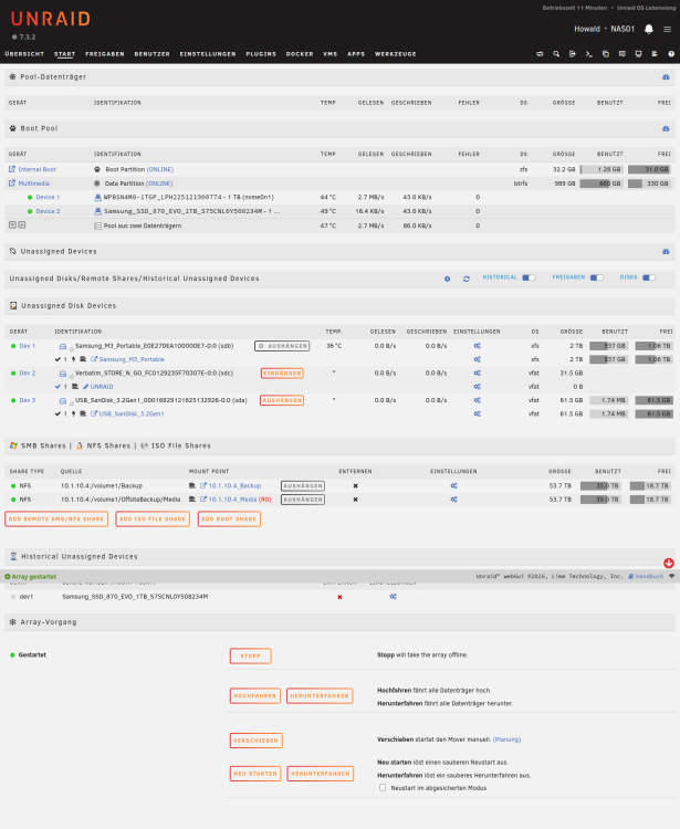

Thanks JorgeB! That’s exactly what I tried, but the “Slots” option simply isn’t there for the boot pool. On the Main page, my regular data pool (“Multimedia”) shows a “Slots: 2” dropdown right below its device list — but the boot pool (“Internal Boot”) has no such row at all, just the device name/status line, nothing to change slot count. Same on the pool’s own detail page (Main → Device → flash) — no slots control anywhere, just Identity/ZFS status/Scrub schedule/Boot device backup.
Array is stopped when I check, so that’s not the issue. Running 7.3.2. Is this a known limitation for single-device boot pools specifically (as opposed to regular pools), or is there a precondition I’m missing to make that control appear?
There's no such limitation; something is wrong with your config. Post a screenshot from Main and the diagnostics.
The boot pool already has two devices assigned; Multimedia is just the data part of the boot pool. They are not two separate pools, though I see that the pool wasn't created correctly, since only the data partition is mirrored. Suggest recreating it.
