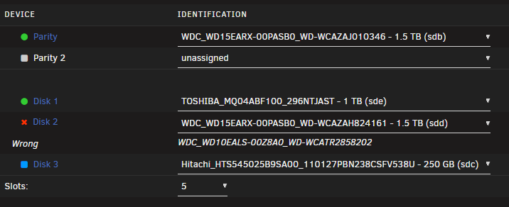

I was upgrading a 250GB drive I had in my array with a 1.5TB one when one of the other disks failed during the rebuild. I tried putting the old 250GB drive back in since it still has everything on it but unraid sees that the drive is smaller than the one I was replacing it with and refuses to start the array. This sounds like it could be fixed since the data on the 250GB drive hasn't been touched at all and only one drive failed.
The old 250GB drive in its old slot, the drive I was going replace it with is going in the dead drive's position (yes it's bigger than the old one)
And Unraid complaining about there being too many wrong disks

The failed disk was disk2, the one I was going to upgrade was disk3.

That changes things; I misunderstood the initial issue. You cannot do a new config.
The diags posted don't show the disk failure; it also looks like you are trying to assign the disk that failed as disk3 as disk2???
Please post the details of how the array was originally configured, or better yet, post the diags after the issue.

Replace disk2 with the drive I was going to upgrade disk3 with; return the old unupgraded disk3 to its old slot. Unraid throws an error about there being too many wrong disks.

You cannot do that, post new diags with all the drives connected and assigned as they were when the disk2 failed.
