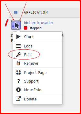

Not quite the method I used. here is a walk through:
1– Left-click on the icon of the container.
Then click on 'Edit':
2– Go to the bottom of the page. click on the 'Show more setting...' dropdown menu.
Check and see if PUID, PGUI and UMASK variable are already defined. If they are– edit them.

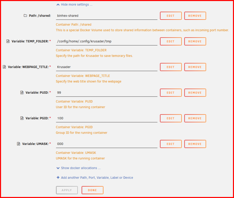

3– If one or more are missing, add them by clicking here:
4– Then follow the instructions from here:
https://forums.unraid.net/topic/188600-share-permissions-changed-to-owner-99/#findComment-1540351
5– When done, it will look something like this:
The first items were already there. The Variables– PUID, PGID and UMASK –were the ones which I had to add for this container.
Hope this helps....
