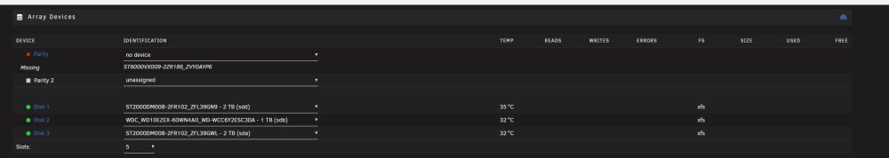

Hello,
I got a used 6TB drive I intended to use for my parity drive. I replaced my existing 4TB parity drive and rebuilt parity. Now, when I stop my array to swap the old 4TB parity drive into my data array, my new parity drive is marked as missing. I haven't had to debug a drive issue since I started using Unraid, so I was hoping that someone could help me out. I see the following in the SYSLOG and have shared the full diagnostics if they are useful.

added screenshot of main tab
