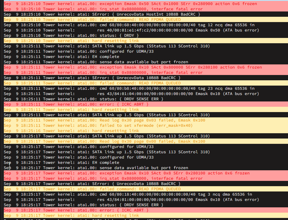

Looks like I'm still getting ATA bus errors and disk1 is showing as Unmountable. I also am getting repeated "interface fatal errors"
Those ICRC abort errors are usually a bad SAT cable; replace just that cable one more time to make sure that's not the problem.
Alright, let's try this again. Swapped out the sata cable and for now I'm no longer seeing the ICRC abort errors or the ATA bus errors. Disk 1 is still showing up as unmountable with wrong or no file system.
