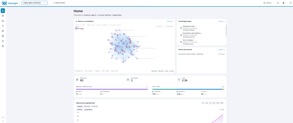

Hindsight is a memory server for AI agents. Your agents save what they work out to it and search it back later, so they stop re-deriving the same decisions every session. It speaks MCP, so anything with MCP support can talk to it: Claude Code, Cursor, Codex, Pi, Grok CLI, and the rest.
I put a template together for it. It runs the official upstream image, which carries the API, the web dashboard, the search models and its own PostgreSQL, so there is nothing else to stand up alongside it.

8888 is the API and the MCP endpoint. 9999 is the dashboard.
There are three keys. Memory API key and Web UI backend key have to hold the same value, and that is the one your agents send as a bearer token. Web UI login key is a separate one, and it is what you type to get into the dashboard.
