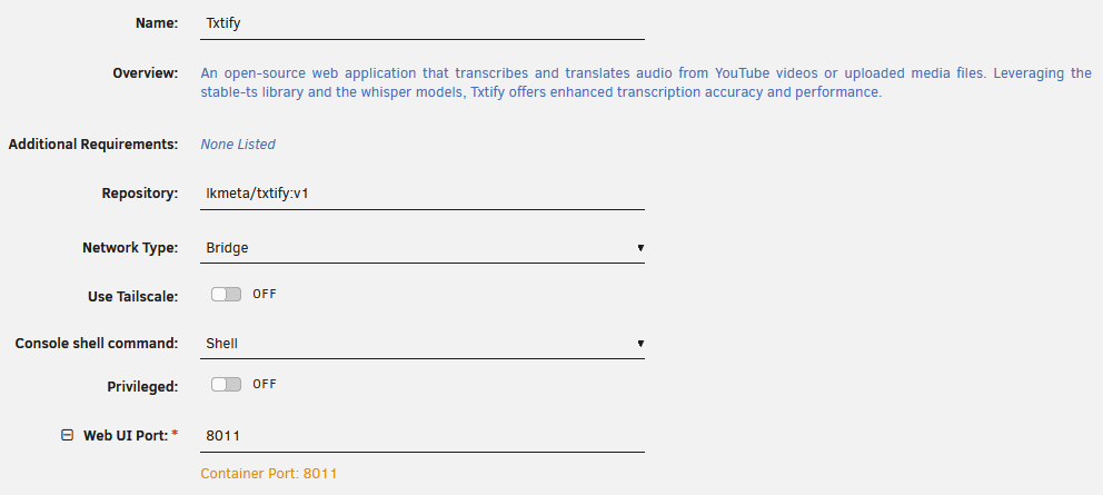

I also had the Txtify Docker container running and working on transcribing some text. I was testing it in the afternoon, and I noticed that the progress windows were stuck at a random percentage, but I don't know if that could have been the culprit.

Txtify has very few settings in the configuration. No mentions about the shares it can use. The elevated setting is off.

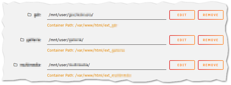

This was the setting I used in the Docker setup:

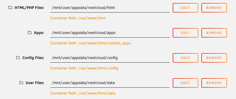

This is the first part of the Docker setup:
Honestly, I can't remember if I selected /var/www/html/etcetc as the "base" folder to mount my external mounts, and/or if I followed some guide, however if the Nextcloud rsync did something in those folders, surely it got my files too :-/

Those Nextcloud logs are a strong clue. The container’s upgrade script uses rsync --delete to update /var/www/html. Nextcloud’s container documentation specifically warns that custom storage mounted inside this directory can lose data during upgrades unless excluded.
If your shares were mapped to /var/www/html/ext_1, /var/www/html/ext_2, and /var/www/html/ext_3, that would fit what you describe. Those mappings expose the original Unraid files inside the container. Deleting files there deletes them from the shares too.
The “Device or resource busy” errors do not mean the files were protected. The mounted directory itself can resist removal after files inside it have already been deleted. The errors do not establish exactly how much was deleted.
Keep Nextcloud stopped and disable its autostart. Repeated starts could attempt the upgrade again. Keep the backup script disabled and preserve the current container configuration and logs before reinstalling or changing anything.
Please post the Nextcloud image repository/tag and the three Host Path → Container Path mappings, including their read/write settings. You can replace personal folder names, but preserve the container path structure.
