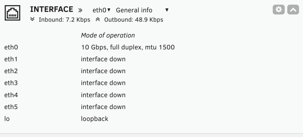

I have 5 network interfaces . The first four are eth0 to eth3 all on the same physical four port card. the next card is my two port fiber card that serve eth4 and eth5. The only physical cable I use is the fiber port on eth4 that goes to my switch. I have the fiber port configured and everything is connected and working. Do I need to do anything to eth0 ? I think Unraid depends on etc0 and it can not be disabled so that is what causes the eth port 0 down alarm that seemingly can't be turned off ? Is that because it is the only port where DNS can be defined ?

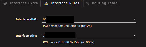

Typically in Interface Rules you'd set the NIC/port you want as main to be eth0.

That did the trick... thanks so much for the help.
