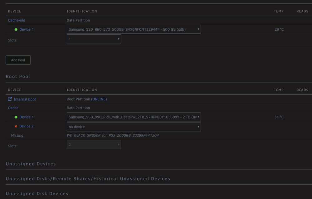

Please also post a screenshot from Main
Kind of a long image, but should have all the info on the main screen.
The problem is with the data partition, but since the diags are after a reboot cannot see what heppen.
I assume there was data there. Also, post the output from btrfs fi show

That confirms the data partition is only using one device still; my recommendation would be to remove the new device from the boot pool, then try adding it again, if it still fails post-new diagnostics before rebooting.
Unassign nvme1n1, start array, stop array, change boot pool slot to 2, and add it again.
